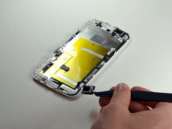

  9. Motorola Moto G 2nd Generation Speakers Replacement, Speakers: crwdns2935265:09crwdnd2935265:01crwdnd2935265:01crwdne2935265:0
    • This is where you will find the two speakers, after you have taken off the motherboard.
  10. Motorola Moto G 2nd Generation Speakers Replacement: crwdns2935265:010crwdnd2935265:01crwdnd2935265:02crwdne2935265:0 Motorola Moto G 2nd Generation Speakers Replacement: crwdns2935265:010crwdnd2935265:02crwdnd2935265:02crwdne2935265:0
    • With the motherboard off, use tweezers to grab the top speaker.
    • Remove the speaker and replace it with a new one.
  11. Motorola Moto G 2nd Generation Speakers Replacement: crwdns2935265:011crwdnd2935265:01crwdnd2935265:02crwdne2935265:0 Motorola Moto G 2nd Generation Speakers Replacement: crwdns2935265:011crwdnd2935265:02crwdnd2935265:02crwdne2935265:0
    • Use tweezers to replace the bottom speaker.

Same problem happened to me when I replaced the screen, had to remove the speaker and when I put it back the upper (left) didn't work and the lower (right) had terrible distortion noise. playing a little with the upper speaker location made it work but with noise as well.
The phone is useless without this speaker, it's pretty shame that nobody pays attention to this point in their guides.

I had a similar problem after replacing my battery. After I put the phone back together, my bottom speaker was not working. I went ahead and ordered a speaker to replace the one that was not working, and it still didn't work. Knowing that my top speaker was working okay, I replaced the top speaker to see if the new one I received was working, and it didn't work on top either. As a matter of fact, I put back the original top speaker that was working okay, and now it doesn't work. So now neither one of them are working. I have to use earphones to hear my phone. I don't know what happened. The instructions to replace the speakers are not that difficult.
Does anyone have any suggestions on what I should do? I'm not ready to give up my phone just yet.

I replaced the speakers recently and it is not recessary to remove the motherboard to replace them.
Dan Eff - crwdns2934203:0crwdne2934203:0
To corroborate with the other commenters: removing the motherboard is unnecessary. The speakers are only held in with a small ring of adhesive, which can easily be pried out. Additionally, the two speakers are identical.
