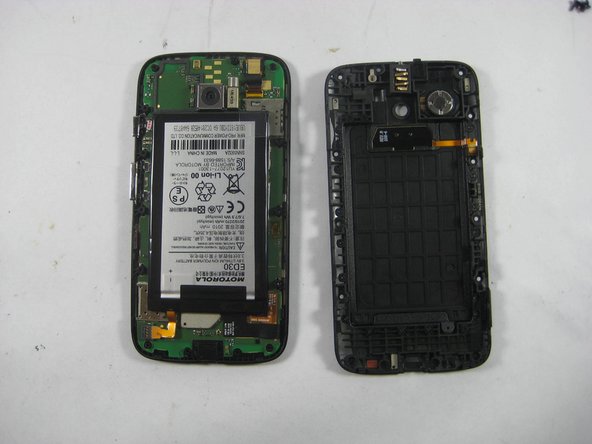

  2. Motorola Moto G 1st Generation Headphone Jack Replacement, Removing the Screws: crwdns2935265:02crwdnd2935265:01crwdnd2935265:01crwdne2935265:0
    • Unscrew the 3.5mm screws, total of 14, located on the back protective cover by using a T5 Torx screwdriver.
  3. Motorola Moto G 1st Generation Headphone Jack Replacement, Removing the Battery Cover: crwdns2935265:03crwdnd2935265:01crwdnd2935265:02crwdne2935265:0 Motorola Moto G 1st Generation Headphone Jack Replacement, Removing the Battery Cover: crwdns2935265:03crwdnd2935265:02crwdnd2935265:02crwdne2935265:0
    • Use a plastic opening tool to remove the protective cover.
    • Carefully work the plastic tool around all the edges of the phone.
    • The protective cover holds the Volume and the Home buttons which might fall off the assembly when the cover is removed.

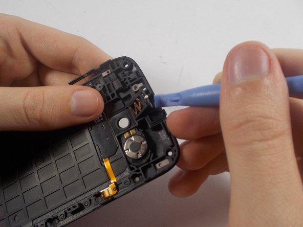

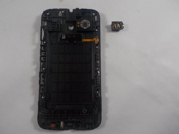

  4. Motorola Moto G 1st Generation Headphone Jack Replacement, Removing the Headphone Jack: crwdns2935265:04crwdnd2935265:01crwdnd2935265:03crwdne2935265:0 Motorola Moto G 1st Generation Headphone Jack Replacement, Removing the Headphone Jack: crwdns2935265:04crwdnd2935265:02crwdnd2935265:03crwdne2935265:0 Motorola Moto G 1st Generation Headphone Jack Replacement, Removing the Headphone Jack: crwdns2935265:04crwdnd2935265:03crwdnd2935265:03crwdne2935265:0
    • Use the plastic opening tool to remove the Headphone Jack from the protective cover and replace it.
