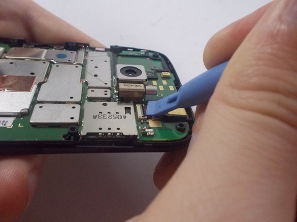

  4. Motorola Moto G 1st Generation Front Camera Replacement, Disconnecting the Front Camera: crwdns2935265:04crwdnd2935265:01crwdnd2935265:02crwdne2935265:0 Motorola Moto G 1st Generation Front Camera Replacement, Disconnecting the Front Camera: crwdns2935265:04crwdnd2935265:02crwdnd2935265:02crwdne2935265:0
    • Use the Pry tool to disconnect the Front Camera, found in the upper right corner, from the motherboard.
    • You want to pry up the black tab that locks it in place. It may be under a protective sticker.
    • Though the battery is removed in our second photo, it is not required for removing the front camera.
