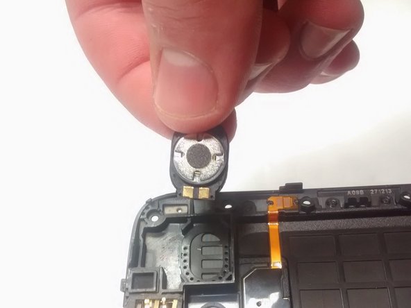

  5. Motorola Moto G 1st Generation Back Speaker Replacement, Locating the Speaker: crwdns2935265:05crwdnd2935265:01crwdnd2935265:01crwdne2935265:0
    • The back speaker will be located on the back plate. It is easily identified by a silver disc with a felt black middle. See it located in the yellow and red circle.
    • Looking at the back plate, it will be on the right.
  6. Motorola Moto G 1st Generation Back Speaker Replacement, Removing the Speaker: crwdns2935265:06crwdnd2935265:01crwdnd2935265:03crwdne2935265:0 Motorola Moto G 1st Generation Back Speaker Replacement, Removing the Speaker: crwdns2935265:06crwdnd2935265:02crwdnd2935265:03crwdne2935265:0 Motorola Moto G 1st Generation Back Speaker Replacement, Removing the Speaker: crwdns2935265:06crwdnd2935265:03crwdnd2935265:03crwdne2935265:0
    • For this procedure it is recommended to use the black plastic pick called a spudger shown in picture.
    • Using flat end, approach the speaker from top direction of case. Carefully and firmly wedge the flat end of spudger between where the speaker meets the case.
    • Gently push the speaker up. It may have some adhesive on the bottom to keep it in place, so some resistance is common.
    • If you find that the speaker is not coming up this is due to the adhesive. It may require multiple attempts, just take your time and stick with it. The area shown in the picture is what we found to be the easiest separation point.

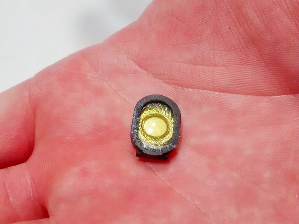

  7. Motorola Moto G 1st Generation Back Speaker Replacement, End Result: crwdns2935265:07crwdnd2935265:01crwdnd2935265:02crwdne2935265:0 Motorola Moto G 1st Generation Back Speaker Replacement, End Result: crwdns2935265:07crwdnd2935265:02crwdnd2935265:02crwdne2935265:0
    • This is the speaker after removal.
    • To replace, line the new speaker up in the space the old one occupied. Gently press until the speaker fits snugly.
