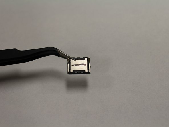

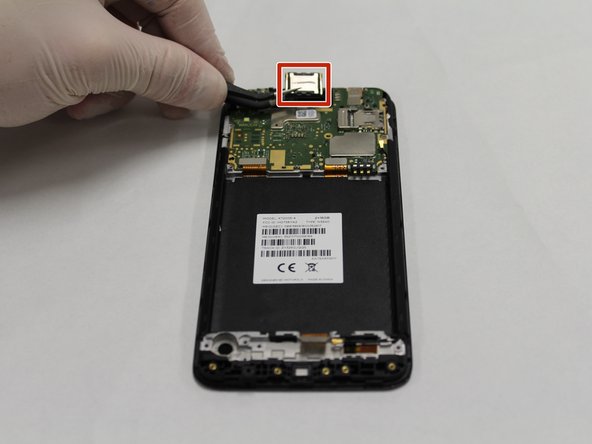

    • Using tweezers, lift the speaker from the motherboard located at the top of the device.
    • When replacing with a new component, make sure the clips are facing towards the user.
