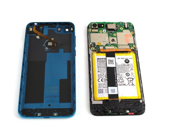

    • Run the halberd spudger along the edges of the device. The back cover should easily pop off.
    • Gently remove the back cover. Do not pull hard, as it is still connected to the fingerprint scanner inside the phone.

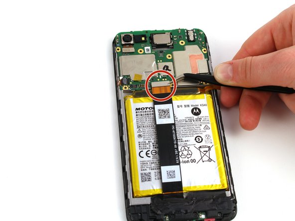

    • The bottom plastic piece covering the daughterboard can be seen by peeling back the tape covering the bottom section of the phone below the battery.
    • To remove the cover, unscrew the six black 3.45 mm Phillips screws holding the cover in place using the Phillips #0 screwdriver.
  5. Motorola Moto E6 Play Front Facing Camera Replacement: crwdns2935265:05crwdnd2935265:01crwdnd2935265:02crwdne2935265:0 Motorola Moto E6 Play Front Facing Camera Replacement: crwdns2935265:05crwdnd2935265:02crwdnd2935265:02crwdne2935265:0
    • Remove the black cover piece using the angled tweezers.

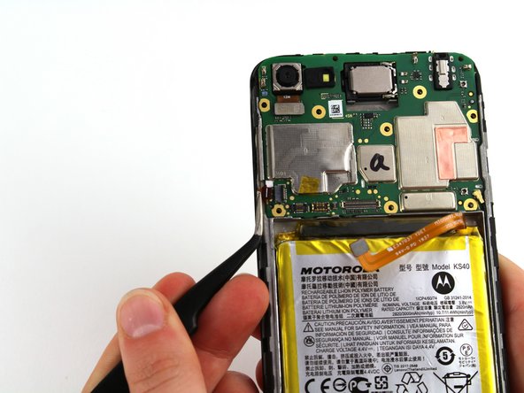

    • Use the angled tweezers to pry off the metal head of the connecting piece from the main motherboard assembly.
  7. Motorola Moto E6 Play Front Facing Camera Replacement: crwdns2935265:07crwdnd2935265:01crwdnd2935265:02crwdne2935265:0 Motorola Moto E6 Play Front Facing Camera Replacement: crwdns2935265:07crwdnd2935265:02crwdnd2935265:02crwdne2935265:0
    • Using the angled tweezers, detach the two connectors from the motherboard by pulling the metallic heads up and away from the phone.

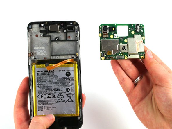

    • Disconnect the rod connected to the motherboard using the angled tweezers.
    • Gently pull the small metal head of the rod up vertically perpendicular from the motherboard, with caution to avoid puncturing the board with the tweezers.
    • Finally, remove the motherboard.

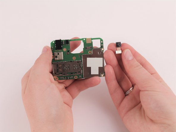

    • Flip the motherboard over to see the back. (The side that does not have the 'a' mark on it.)
    • Using the angled tweezers, lift the tab at the bottom of the camera piece and remove the front facing camera from the circuit board.
