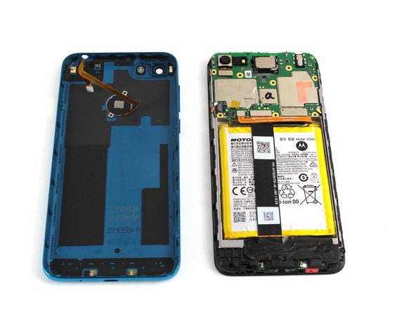

    • Run the halberd spudger along the edges of the device. The back cover should easily pop off.
    • Gently remove the back cover. Do not pull hard, as it is still connected to the fingerprint scanner inside the phone.

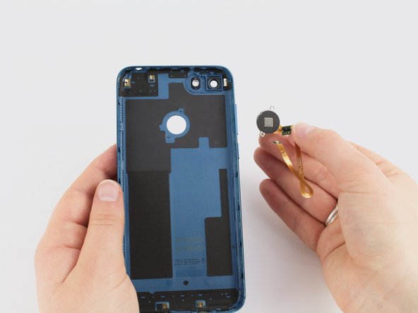

    • Use the angled tweezers to pry off the metal head of the connecting piece from the main motherboard assembly.
  7. Motorola Moto E6 Play Fingerprint Scanner Replacement: crwdns2935265:07crwdnd2935265:01crwdnd2935265:02crwdne2935265:0 Motorola Moto E6 Play Fingerprint Scanner Replacement: crwdns2935265:07crwdnd2935265:02crwdnd2935265:02crwdne2935265:0
    • Use the angled tweezers to pull up on the two tabs connecting the scanner to the back plastic panel, and disconnect the fingerprint scanner from the back of the device.
