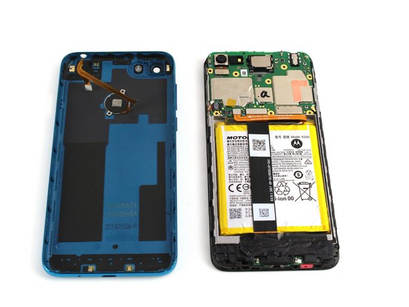

    • Run the halberd spudger along the edges of the device. The back cover should easily pop off.
    • Gently remove the back cover. Do not pull hard, as it is still connected to the fingerprint scanner inside the phone.

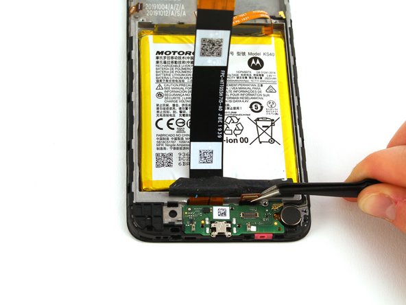

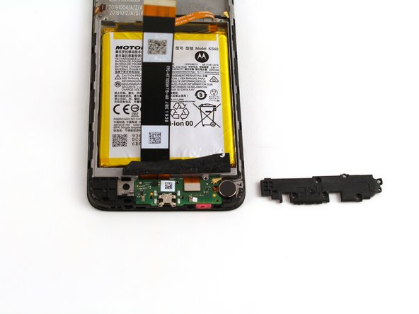

  4. Motorola Moto E6 Play Display Assembly Replacement: crwdns2935265:04crwdnd2935265:01crwdnd2935265:03crwdne2935265:0 Motorola Moto E6 Play Display Assembly Replacement: crwdns2935265:04crwdnd2935265:02crwdnd2935265:03crwdne2935265:0 Motorola Moto E6 Play Display Assembly Replacement: crwdns2935265:04crwdnd2935265:03crwdnd2935265:03crwdne2935265:0

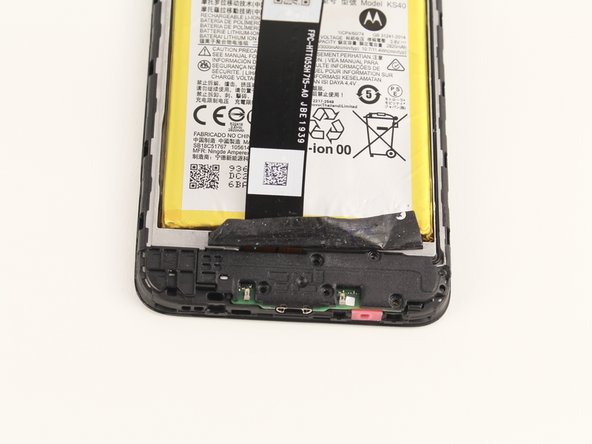

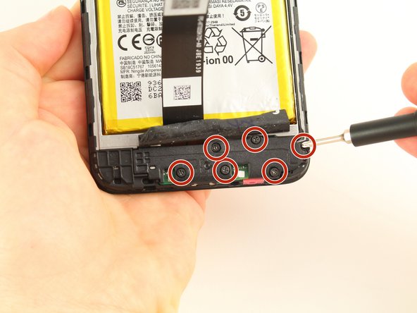

    • The bottom plastic piece covering the daughterboard can be seen by peeling back the tape covering the bottom section of the phone below the battery.
    • To remove the cover, unscrew the six black 3.45 mm Phillips screws holding the cover in place using the Phillips #0 screwdriver.
  5. Motorola Moto E6 Play Display Assembly Replacement: crwdns2935265:05crwdnd2935265:01crwdnd2935265:02crwdne2935265:0 Motorola Moto E6 Play Display Assembly Replacement: crwdns2935265:05crwdnd2935265:02crwdnd2935265:02crwdne2935265:0
    • Remove the black cover piece using the angled tweezers.

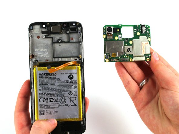

  6. Motorola Moto E6 Play Display Assembly Replacement, Display Assembly: crwdns2935265:06crwdnd2935265:01crwdnd2935265:02crwdne2935265:0 Motorola Moto E6 Play Display Assembly Replacement, Display Assembly: crwdns2935265:06crwdnd2935265:02crwdnd2935265:02crwdne2935265:0
    $3.99

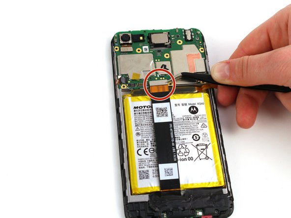

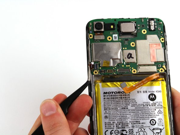

    • Use the angled tweezers to pry off the metal head of the connecting piece from the motherboard assembly.
  7. Motorola Moto E6 Play Display Assembly Replacement: crwdns2935265:07crwdnd2935265:01crwdnd2935265:02crwdne2935265:0 Motorola Moto E6 Play Display Assembly Replacement: crwdns2935265:07crwdnd2935265:02crwdnd2935265:02crwdne2935265:0
    • Using the angled tweezers, detach the two connectors from the motherboard by pulling the metallic head vertically perpendicular from the phone.
  8. Motorola Moto E6 Play Display Assembly Replacement: crwdns2935265:08crwdnd2935265:01crwdnd2935265:02crwdne2935265:0 Motorola Moto E6 Play Display Assembly Replacement: crwdns2935265:08crwdnd2935265:02crwdnd2935265:02crwdne2935265:0
    • Use the angled tweezers to flip the black plastic piece from flat to upright.
    • This will allow you to separate the mini connector from the motherboard later.
  9. Motorola Moto E6 Play Display Assembly Replacement: crwdns2935265:09crwdnd2935265:01crwdnd2935265:02crwdne2935265:0 Motorola Moto E6 Play Display Assembly Replacement: crwdns2935265:09crwdnd2935265:02crwdnd2935265:02crwdne2935265:0
    • Disconnect the rod connected to the motherboard using the angled tweezers.
    • Gently pull the small metal head of the vertically perpendicular from the motherboard, with caution to avoid puncturing the board with the tweezers.

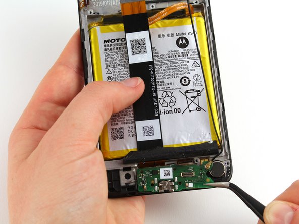

  10. Motorola Moto E6 Play Display Assembly Replacement: crwdns2935265:010crwdnd2935265:01crwdnd2935265:03crwdne2935265:0 Motorola Moto E6 Play Display Assembly Replacement: crwdns2935265:010crwdnd2935265:02crwdnd2935265:03crwdne2935265:0 Motorola Moto E6 Play Display Assembly Replacement: crwdns2935265:010crwdnd2935265:03crwdnd2935265:03crwdne2935265:0
    • Using the angled tweezers, disconnect the clip connecting the daughterboard to the battery by pulling the metal head vertically perpendicular to the phone.
    • Then, remove the circuit board.

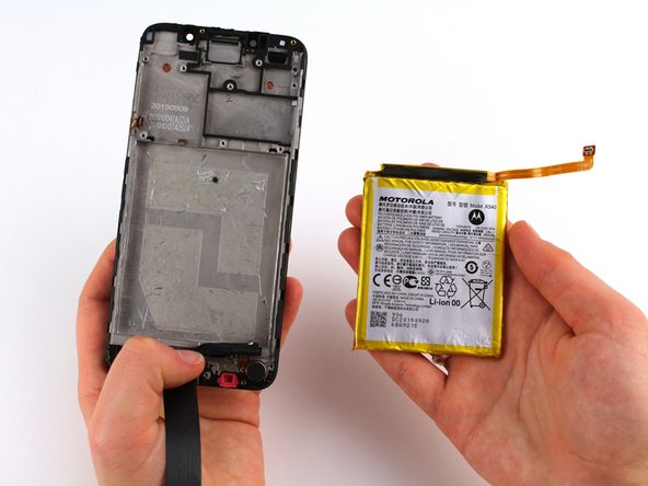

  12. Motorola Moto E6 Play Display Assembly Replacement: crwdns2935265:012crwdnd2935265:01crwdnd2935265:02crwdne2935265:0 Motorola Moto E6 Play Display Assembly Replacement: crwdns2935265:012crwdnd2935265:02crwdnd2935265:02crwdne2935265:0
    • Remove the battery by inserting the spudger under the battery and gently pulling it up from the device to loosen the adhesive glue underneath.
    • Continue to push the spudger towards the center of the compartment holding the battery, and gently pry the battery away from the device.
    • In this image, the metal spudger is used. However, you should NOT use a metal spudger to remove the battery. Use the plastic spudger instead, as this is less likely to puncture the battery.
