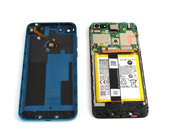

    • Run the halberd spudger along the edges of the device. The back cover should easily pop off.
    • Gently remove the back cover. Do not pull hard, as it is still connected to the fingerprint scanner inside the phone.

    • Remove the battery by inserting the spudger under the battery and gently pulling it up from the device.
    • Continue to push the spudger towards the center of the compartment holding the battery, and gently pry the battery away from the device.
    • In this image, the metal spudger is used. However, you should NOT use a metal spudger to remove the battery. Use the plastic spudger instead, as this is less likely to puncture the battery.
    • In these images, both circuit boards are removed, but this isn't necessary to remove the battery.
