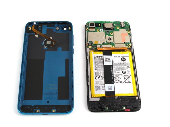

    • Run the halberd spudger along the edges of the device. The back cover should easily pop off.
    • Gently remove the back cover. Do not pull hard, as it is still connected to the fingerprint scanner inside the phone.

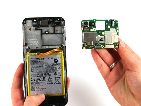

    • With the angled tweezers, remove the black cover to reveal the motherboard underneath.
    • Remove the black piece cover with caution to avoid puncturing the motherboard with the tweezers.

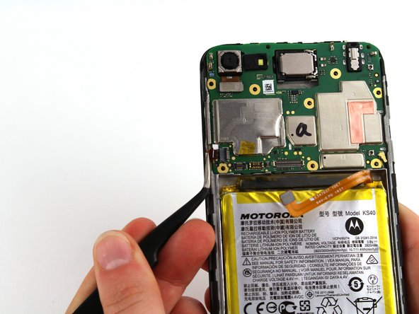

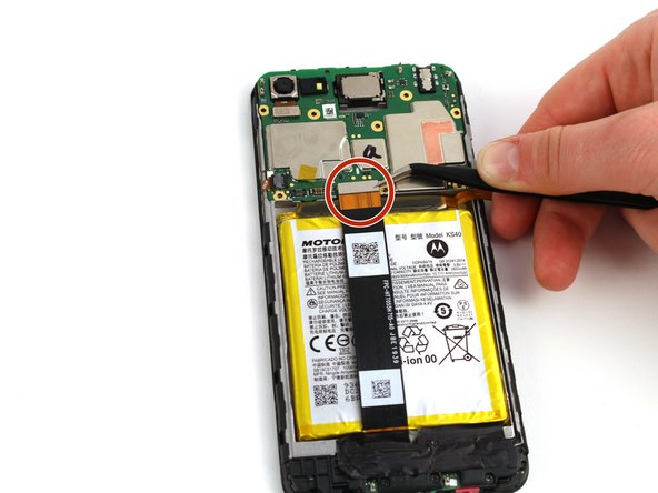

    • Use the angled tweezers to pry off the metal head of the connecting piece from the main motherboard assembly.
  7. Motorola Moto E6 Play Back Facing Camera Replacement: crwdns2935265:07crwdnd2935265:01crwdnd2935265:02crwdne2935265:0 Motorola Moto E6 Play Back Facing Camera Replacement: crwdns2935265:07crwdnd2935265:02crwdnd2935265:02crwdne2935265:0
    • Using the angled tweezers, detach the two connectors from the motherboard by pulling the metallic head up and away from the phone.
  8. Motorola Moto E6 Play Back Facing Camera Replacement: crwdns2935265:08crwdnd2935265:01crwdnd2935265:02crwdne2935265:0 Motorola Moto E6 Play Back Facing Camera Replacement: crwdns2935265:08crwdnd2935265:02crwdnd2935265:02crwdne2935265:0
    • Use the angled tweezers to flip the black plastic piece from flat to upright.
    • This will allow you to separate the mini connector from the motherboard later.
  9. Motorola Moto E6 Play Back Facing Camera Replacement: crwdns2935265:09crwdnd2935265:01crwdnd2935265:02crwdne2935265:0 Motorola Moto E6 Play Back Facing Camera Replacement: crwdns2935265:09crwdnd2935265:02crwdnd2935265:02crwdne2935265:0
    • Disconnect the rod connected to the motherboard using the angled tweezers.
    • Gently pull the small metal head of the vertically perpendicular from the motherboard with caution to avoid puncturing the board with the tweezers.

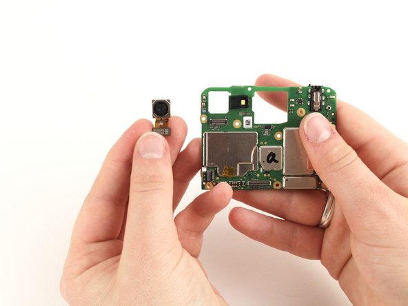

    • Using the angled tweezers, gently lift and pull the tab at the bottom of the camera to remove the back facing camera from the circuit board.
