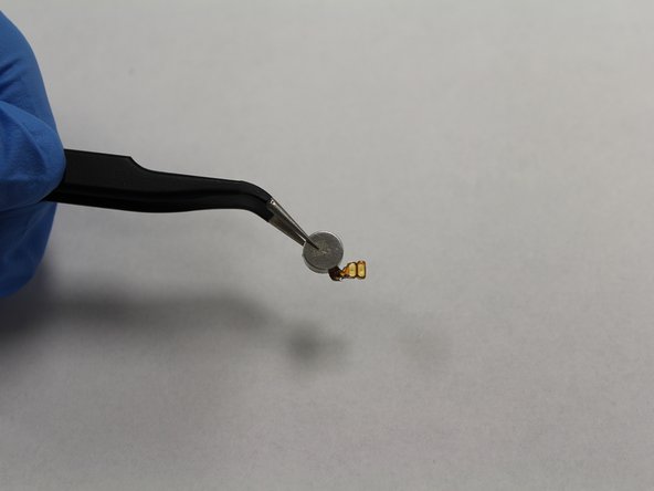

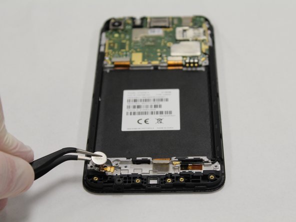

  7. Motorola Moto E6 Haptic Feedback Motor Replacement, Haptic Feedback Motor: crwdns2935265:07crwdnd2935265:01crwdnd2935265:03crwdne2935265:0 Motorola Moto E6 Haptic Feedback Motor Replacement, Haptic Feedback Motor: crwdns2935265:07crwdnd2935265:02crwdnd2935265:03crwdne2935265:0 Motorola Moto E6 Haptic Feedback Motor Replacement, Haptic Feedback Motor: crwdns2935265:07crwdnd2935265:03crwdnd2935265:03crwdne2935265:0
    • Using tweezers, gently lift the haptic feedback motor out of its position in the bottom left corner of the device.
