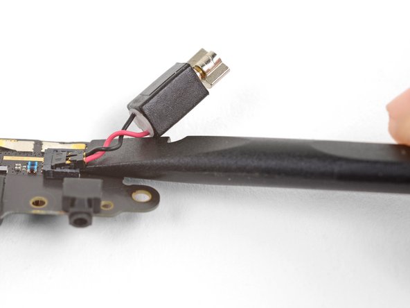

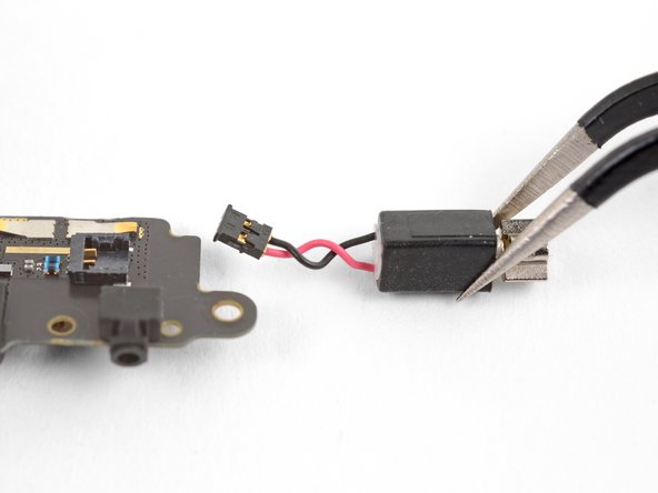

  13. Motorola Moto E4 Plus Vibration Motor Replacement, Vibration Motor: crwdns2935265:013crwdnd2935265:01crwdnd2935265:03crwdne2935265:0 Motorola Moto E4 Plus Vibration Motor Replacement, Vibration Motor: crwdns2935265:013crwdnd2935265:02crwdnd2935265:03crwdne2935265:0 Motorola Moto E4 Plus Vibration Motor Replacement, Vibration Motor: crwdns2935265:013crwdnd2935265:03crwdnd2935265:03crwdne2935265:0
    • Do not pull the connector out by the cables. It snaps in place from the top.
    • Insert the flat edge of a spudger between the vibration motor wires and the daughterboard
    • Gently twist to pry the connector upwards out of its socket.
