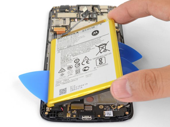

  8. Motorola Moto E4 Plus Power and Volume Buttons Replacement, Loosen the battery: crwdns2935265:08crwdnd2935265:01crwdnd2935265:02crwdne2935265:0 Motorola Moto E4 Plus Power and Volume Buttons Replacement, Loosen the battery: crwdns2935265:08crwdnd2935265:02crwdnd2935265:02crwdne2935265:0
    • Insert an opening pick into the top right edge of the battery.
    • Push the opening pick in carefully until half of the pick is under the battery.
  9. Motorola Moto E4 Plus Power and Volume Buttons Replacement: crwdns2935265:09crwdnd2935265:01crwdnd2935265:01crwdne2935265:0
    • Fill a plastic dropper or syringe with high concentration isopropyl alcohol and apply a few drops of alcohol along the right edge of the battery.
    • Tilt the edge up slightly for a minute to allow the isopropyl alcohol to soften the adhesive.
  10. Motorola Moto E4 Plus Power and Volume Buttons Replacement: crwdns2935265:010crwdnd2935265:01crwdnd2935265:02crwdne2935265:0 Motorola Moto E4 Plus Power and Volume Buttons Replacement: crwdns2935265:010crwdnd2935265:02crwdnd2935265:02crwdne2935265:0
    • As you slice through the adhesive with the opening pick, try your best not to bend the battery pack. Soft shell lithium-ion batteries are highly susceptible to damage and can ignite when compromised.
    • Insert another opening pick into the right edge, near the first opening pick.
    • Slide the opening pick down along the right edge to loosen the right adhesive strip.
    • If the slicing feels difficult, apply a few more drops of isopropyl alcohol into the edge, wait a minute for it to seep in, and try again.

    • Grasp the battery along the right corners and slowly lift the right edge upwards.
    • If the battery begins to bend significantly, stop and re-apply more isopropyl alcohol to the left adhesive strip.
  13. Motorola Moto E4 Plus Power and Volume Buttons Replacement: crwdns2935265:013crwdnd2935265:01crwdnd2935265:01crwdne2935265:0
    • Remove the battery.
    • Do not reuse the battery after it has been removed, as doing so is a potential safety hazard. Replace it with a new battery.

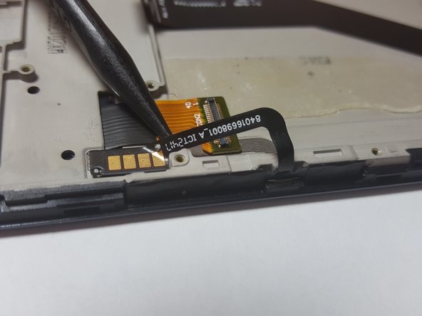

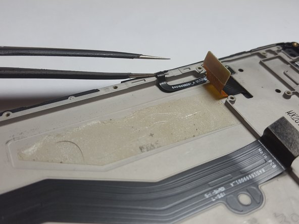

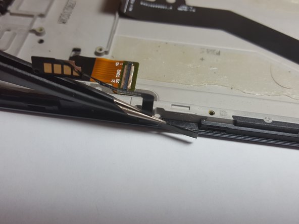

  19. Motorola Moto E4 Plus Power and Volume Buttons Replacement, Power and Volume Buttons: crwdns2935265:019crwdnd2935265:01crwdnd2935265:03crwdne2935265:0 Motorola Moto E4 Plus Power and Volume Buttons Replacement, Power and Volume Buttons: crwdns2935265:019crwdnd2935265:02crwdnd2935265:03crwdne2935265:0 Motorola Moto E4 Plus Power and Volume Buttons Replacement, Power and Volume Buttons: crwdns2935265:019crwdnd2935265:03crwdnd2935265:03crwdne2935265:0
    • Use the Precision Tweezer to detach the Power and Volume Buttons Flex. Start at the lip of the phone, as seen in Image 2, and lift up. Slide the precision tweezers under the power and volume buttons flex until you reach the gold plated section, detaching it from the phone.

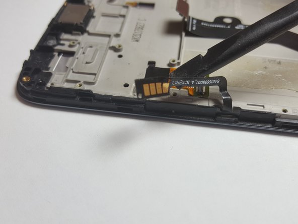

  20. Motorola Moto E4 Plus Power and Volume Buttons Replacement: crwdns2935265:020crwdnd2935265:01crwdnd2935265:02crwdne2935265:0 Motorola Moto E4 Plus Power and Volume Buttons Replacement: crwdns2935265:020crwdnd2935265:02crwdnd2935265:02crwdne2935265:0
    • Use the Plastic Spudger to finish lifting the volume and power buttons flex from the base of the phone.

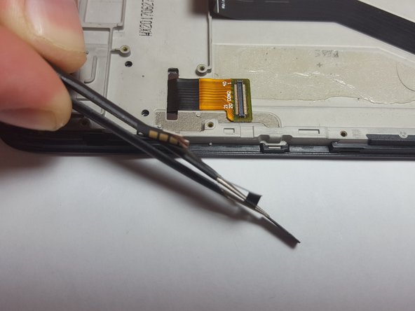

  21. Motorola Moto E4 Plus Power and Volume Buttons Replacement: crwdns2935265:021crwdnd2935265:01crwdnd2935265:03crwdne2935265:0 Motorola Moto E4 Plus Power and Volume Buttons Replacement: crwdns2935265:021crwdnd2935265:02crwdnd2935265:03crwdne2935265:0 Motorola Moto E4 Plus Power and Volume Buttons Replacement: crwdns2935265:021crwdnd2935265:03crwdnd2935265:03crwdne2935265:0
    • Use the Precision Tweezers to pull the volume and power buttons off of the side of the phone, as seen in the pictures. It is all one piece and will be pulled off together.
    • Do not be afraid to pull with some force to remove the buttons. The buttons are connected by an adhesive but can be pulled off easily, be confident in the strength of the buttons.

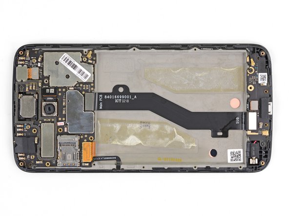

  22. Motorola Moto E4 Plus Power and Volume Buttons Replacement: crwdns2935265:022crwdnd2935265:01crwdnd2935265:01crwdne2935265:0
    • This is the result of removing the volume and power buttons flex from the phone.
