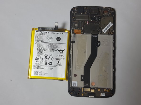

    • After removing the back panel, use the spudger to lift and detach the Battery Flux Cable from the Motherboard.

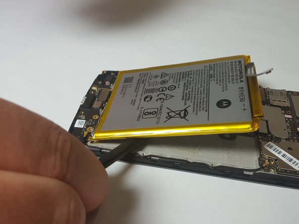

  5. Motorola Moto E4 Plus Earpiece Replacement: crwdns2935265:05crwdnd2935265:01crwdnd2935265:03crwdne2935265:0 Motorola Moto E4 Plus Earpiece Replacement: crwdns2935265:05crwdnd2935265:02crwdnd2935265:03crwdne2935265:0 Motorola Moto E4 Plus Earpiece Replacement: crwdns2935265:05crwdnd2935265:03crwdnd2935265:03crwdne2935265:0
    • Wedge the spudger between the battery and the phone to lift the battery up and remove the battery. There will be slight resistance to this but the battery will not be damaged by this. It is just the adhesive tape.

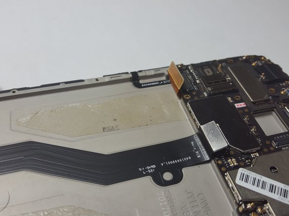

  10. Motorola Moto E4 Plus Earpiece Replacement: crwdns2935265:010crwdnd2935265:01crwdnd2935265:02crwdne2935265:0 Motorola Moto E4 Plus Earpiece Replacement: crwdns2935265:010crwdnd2935265:02crwdnd2935265:02crwdne2935265:0
    • Use the Spudger to lift up and detach the Main Flex Cable from the Motherboard.
  11. Motorola Moto E4 Plus Earpiece Replacement: crwdns2935265:011crwdnd2935265:01crwdnd2935265:02crwdne2935265:0 Motorola Moto E4 Plus Earpiece Replacement: crwdns2935265:011crwdnd2935265:02crwdnd2935265:02crwdne2935265:0
    • Use the Spudger to lift up and detach the LCD Screen Flex Cable from the Motherboard.

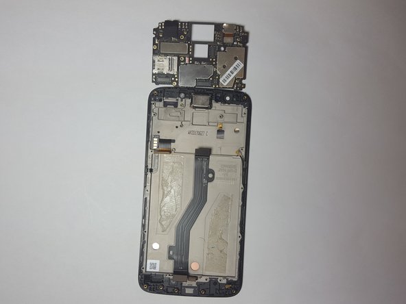

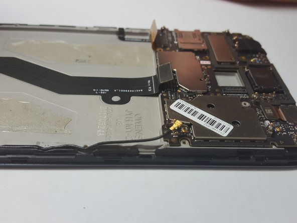

  12. Motorola Moto E4 Plus Earpiece Replacement: crwdns2935265:012crwdnd2935265:01crwdnd2935265:01crwdne2935265:0
    • Use the Plastic Spudger to lift up and detach the Signal Flex Cable from the Motherboard. The Signal Flex Cable should still be attached to the body of the phone.
  13. Motorola Moto E4 Plus Earpiece Replacement: crwdns2935265:013crwdnd2935265:01crwdnd2935265:02crwdne2935265:0 Motorola Moto E4 Plus Earpiece Replacement: crwdns2935265:013crwdnd2935265:02crwdnd2935265:02crwdne2935265:0
    • Use the Spudger to lift up and remove the Motherboard from the phone.

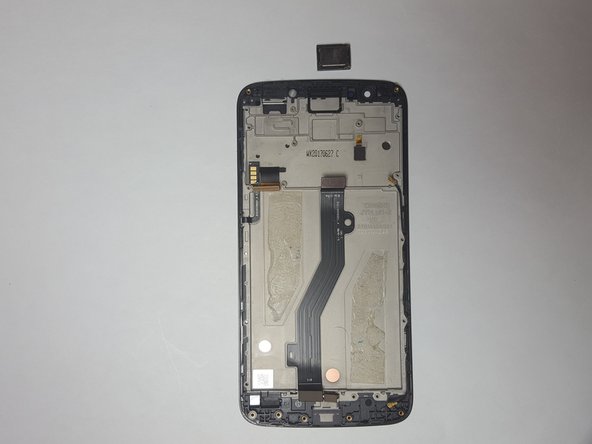

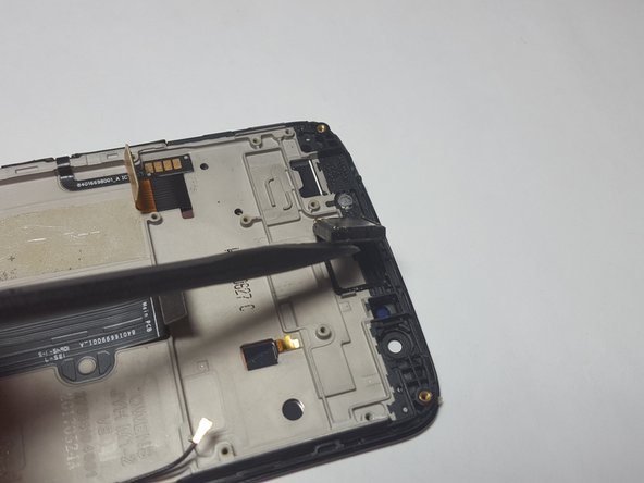

  14. Motorola Moto E4 Plus Earpiece Replacement, Earpiece Speaker: crwdns2935265:014crwdnd2935265:01crwdnd2935265:03crwdne2935265:0 Motorola Moto E4 Plus Earpiece Replacement, Earpiece Speaker: crwdns2935265:014crwdnd2935265:02crwdnd2935265:03crwdne2935265:0 Motorola Moto E4 Plus Earpiece Replacement, Earpiece Speaker: crwdns2935265:014crwdnd2935265:03crwdnd2935265:03crwdne2935265:0
    • Use the Plastic Spudger to remove the Earpiece Speaker from the phone.
