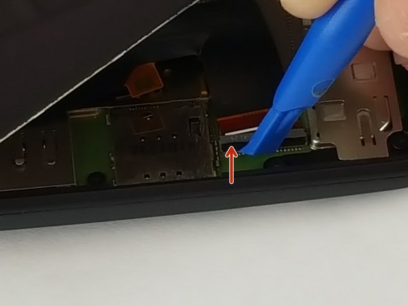

    • Once display is fully unglued from the frame, carefully lift it up and locate the display connector.
    • Using the same small plastic tool, carefully remove the yellow tape off the connector.
    • Now carefully undo the black connector lock by lifting it up in the direction of the red arrow.
    • Do not pry on the gray part of the connector.
    • Lastly slide the display cable off the connector. It should easily slide off, if not make sure the black lock is fully unlatched.

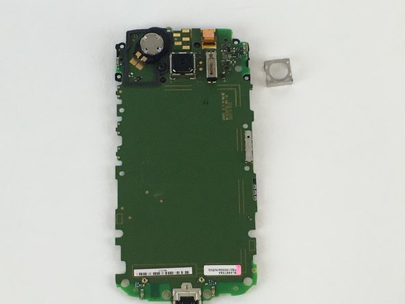

  10. Motorola Moto E 2nd Generation Rear Facing Camera Replacement, Rear Facing Camera: crwdns2935265:010crwdnd2935265:01crwdnd2935265:02crwdne2935265:0 Motorola Moto E 2nd Generation Rear Facing Camera Replacement, Rear Facing Camera: crwdns2935265:010crwdnd2935265:02crwdnd2935265:02crwdne2935265:0
    • Using a spudger (ignore the pictured screwdriver), pry up the metal square frame on each side until it comes off.

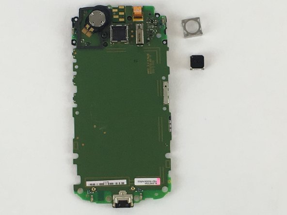

  11. Motorola Moto E 2nd Generation Rear Facing Camera Replacement: crwdns2935265:011crwdnd2935265:01crwdnd2935265:02crwdne2935265:0 Motorola Moto E 2nd Generation Rear Facing Camera Replacement: crwdns2935265:011crwdnd2935265:02crwdnd2935265:02crwdne2935265:0
    • Once the metal square frame is out, use the same tool to pry up the camera by gently pulling on each side until it comes off
