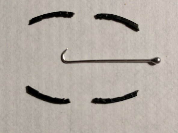

    1. Motorola Moto 360 Case Locking Fastener Replacement, Case Locking Fasteners: crwdns2935265:04crwdnd2935265:01crwdnd2935265:01crwdne2935265:0
      • Locate the rectangular end of the fastener inside the wrist strap mounting pocket.
    2. Motorola Moto 360 Case Locking Fastener Replacement: crwdns2935265:05crwdnd2935265:01crwdnd2935265:02crwdne2935265:0 Motorola Moto 360 Case Locking Fastener Replacement: crwdns2935265:05crwdnd2935265:02crwdnd2935265:02crwdne2935265:0
      • Push the point of the pin in behind the fastener and pry it out. There is a notch near the end of the fastener which will engage the pin. Once the end pops out, the fastener will slide out of the slot easliy. Repeat to remove all four of them.
      • That's it. Now the two halves of the watch can be easily separated by just pulling gently with your fingers.

One misleading thing about this guide: pictures show the back cover taken off, while in fact you don't need to do this -- just take out the fasteners.
Дмитрий Трубин (Dmitry Trubin) - crwdns2934203:0crwdne2934203:0 crwdns2950251:0crwdne2950251:0
Absolutely correct, you don't need to heat or take the back off. I will say though that getting those clips out was damnably fiddly for me.

don't remove the back!
follow this video for removing the locking pins.
I did it, so can you!
https://www.youtube.com/watch?v=Jw3n5qbG...
