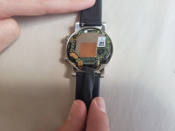

    • Use a T4 Torx screwdriver to remove the four 4.2 mm screws securing the lower case.
    • Gently pry the case open with a halberd spudger if the case will not release after removing the bolts.
    • Do not remove the lower case completely yet; this could damage cables connected to the lower case.

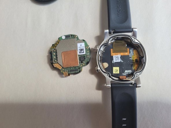

    • Disconnect the right (small, black head) and bottom right (wide, orange head) ribbon cables.
    • No need to disconnect the left or bottom left ribbons.

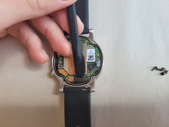

    • Gently remove the motherboard using a halberd spudger.
    • The best area to pry is at the bottom of the motherboard, right under one of the ribbons that was just disconnected.

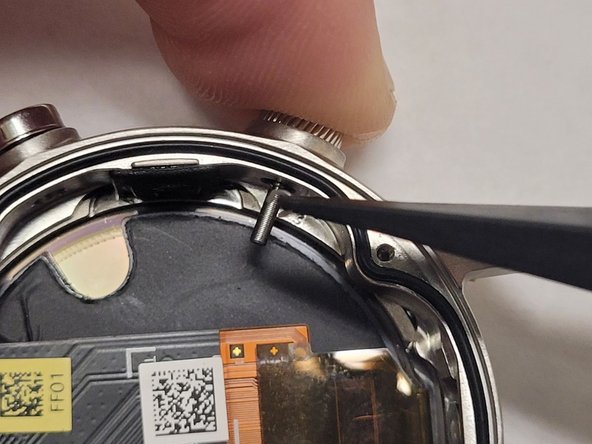

    • While pushing the Multi-Action Button inwards, use tweezers to remove the c-clamp holding the button in place.
    • The c-clamp is a very tiny object, be cautious of losing it.
    • Remove the Multi-Action Button.

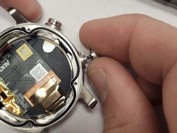

    • Insert the new Multi-Action Button in place of the older Multi-Action Button.
    • Attach the c-clamp back around the Multi-Action Button while it is being pushed inwards.
