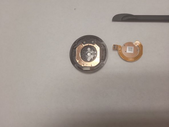

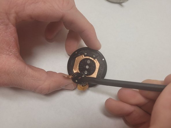

  3. Motorola Moto 360 3rd Gen Charging Coil Replacement, Charging Coil: crwdns2935265:03crwdnd2935265:01crwdnd2935265:03crwdne2935265:0 Motorola Moto 360 3rd Gen Charging Coil Replacement, Charging Coil: crwdns2935265:03crwdnd2935265:02crwdnd2935265:03crwdne2935265:0 Motorola Moto 360 3rd Gen Charging Coil Replacement, Charging Coil: crwdns2935265:03crwdnd2935265:03crwdnd2935265:03crwdne2935265:0
    • Gently wedge a spudger underneath the charging coil ribbon.
    • Carefully pry the charging coil up and remove it from the assembly.
  4. Motorola Moto 360 3rd Gen Charging Coil Replacement: crwdns2935265:04crwdnd2935265:01crwdnd2935265:02crwdne2935265:0 Motorola Moto 360 3rd Gen Charging Coil Replacement: crwdns2935265:04crwdnd2935265:02crwdnd2935265:02crwdne2935265:0
    • Place the new charging coil in the same orientation as the one previously removed.
    • Attach the charging coil ribbon cable to the watch motherboard.
