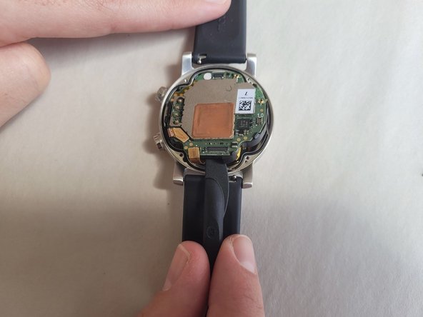

    • Use a T4 Torx screwdriver to remove the four 4.2 mm screws securing the lower case.
    • Gently pry the case open with a halberd spudger if the case will not release after removing the bolts.
    • Do not remove the lower case completely yet; this could damage cables connected to the lower case.
  2. Motorola Moto 360 3rd Gen Battery Replacement: crwdns2935265:02crwdnd2935265:01crwdnd2935265:01crwdne2935265:0
    • Raise the cover without straining the connected ribbon cable.
    • Disconnect the ribbon cable from the motherboard with a halberd spudger.

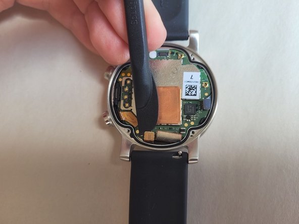

    • Use a halberd spudger to lift the three flat-top connectors straight up to disconnect them.
    • Do not disconnect the battery (bottom-left) cable yet.

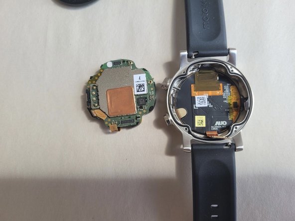

    • Gently remove the motherboard using the halberd spudger.
    • The best area to pry is at the bottom of the motherboard, right under one of the ribbons that was just disconnected.

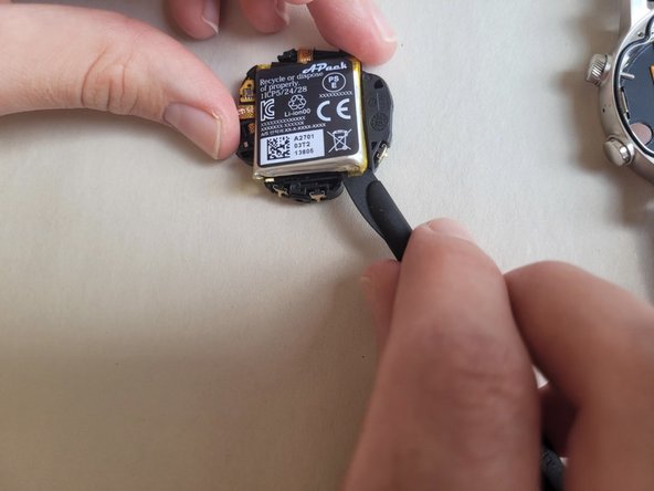

    • Flip the motherboard over so the battery is facing upwards.
    • Gently pry the battery out of the motherboard housing.
    • The best area to pry is at the top-left corner.
    • Take care not to puncture, bend, or twist the battery while removing it. A damaged battery can start a fire!
    • Disconnect the battery ribbon from the motherboard using the spudger tool.
  6. Motorola Moto 360 3rd Gen Battery Replacement: crwdns2935265:06crwdnd2935265:01crwdnd2935265:02crwdne2935265:0 Motorola Moto 360 3rd Gen Battery Replacement: crwdns2935265:06crwdnd2935265:02crwdnd2935265:02crwdne2935265:0
    • Connect the new battery's ribbon to the motherboard.
    • Insert the new battery in the same orientation the old battery previously had.
To reassemble your device, follow these instructions in reverse order carefully.
