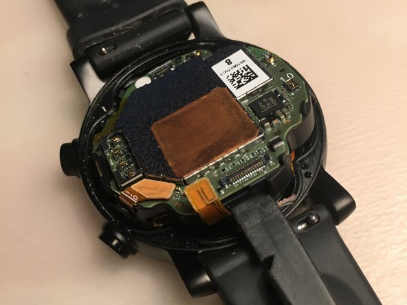

    • Unscrew the 4 bolts with your T4 screwdriver.
    • If the cover is stuck, gently pry open with a spudger.
    • Do not remove the cover completely, it could damage the watch.

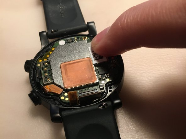

    • Gently raise the cover.
    • Disconnect the cable with your spudger.

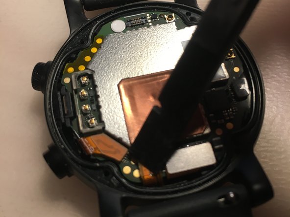

  3. Motorola Moto 360 3rd Gen Battery  Replacement, Disconnect all the ribbons: crwdns2935265:03crwdnd2935265:01crwdnd2935265:03crwdne2935265:0 Motorola Moto 360 3rd Gen Battery  Replacement, Disconnect all the ribbons: crwdns2935265:03crwdnd2935265:02crwdnd2935265:03crwdne2935265:0 Motorola Moto 360 3rd Gen Battery  Replacement, Disconnect all the ribbons: crwdns2935265:03crwdnd2935265:03crwdnd2935265:03crwdne2935265:0

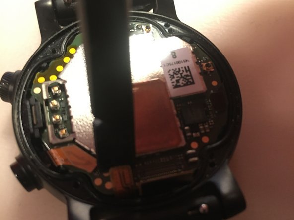

    • Gently disconnect the ribbons with your spudger.
    • Do not remove the bottom-left cable.

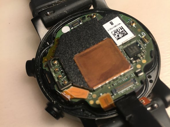

  4. Motorola Moto 360 3rd Gen Battery  Replacement, Remove the motherboard: crwdns2935265:04crwdnd2935265:01crwdnd2935265:03crwdne2935265:0 Motorola Moto 360 3rd Gen Battery  Replacement, Remove the motherboard: crwdns2935265:04crwdnd2935265:02crwdnd2935265:03crwdne2935265:0 Motorola Moto 360 3rd Gen Battery  Replacement, Remove the motherboard: crwdns2935265:04crwdnd2935265:03crwdnd2935265:03crwdne2935265:0

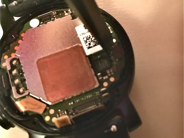

    • Gently remove the motherboard.
    • Place your spudger under the board and lever up.

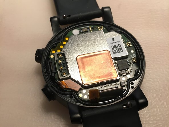

  5. Motorola Moto 360 3rd Gen Battery  Replacement, Remove the battery: crwdns2935265:05crwdnd2935265:01crwdnd2935265:03crwdne2935265:0 Motorola Moto 360 3rd Gen Battery  Replacement, Remove the battery: crwdns2935265:05crwdnd2935265:02crwdnd2935265:03crwdne2935265:0 Motorola Moto 360 3rd Gen Battery  Replacement, Remove the battery: crwdns2935265:05crwdnd2935265:03crwdnd2935265:03crwdne2935265:0

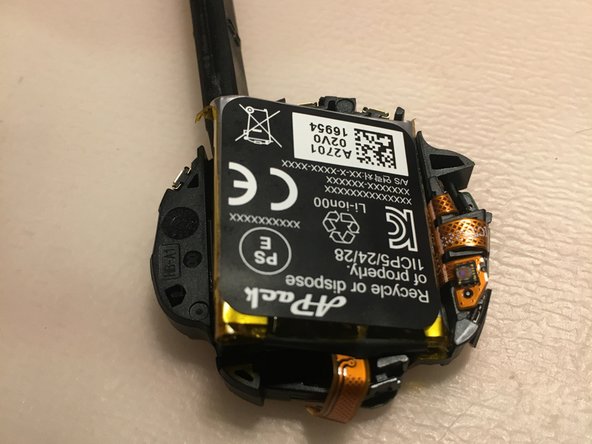

    • Turn the motherboard around so that you see the battery. The battery connection needs to be at the bottom.
    • Gently pry the battery. The easiest way to do so is in the top-left corner.

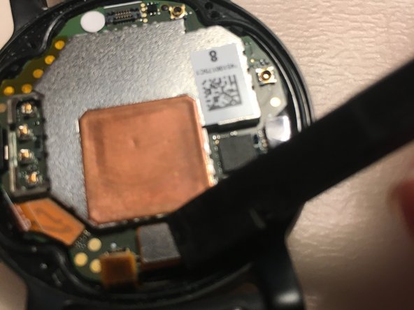

    • Reconnect all the cables.
    • Note: You can use your spudger but a finger does it.

Where did you get the replacement battery? Model APP00306
txwalk - crwdns2934203:0crwdne2934203:0
I didn’t get another one. For this guide I just used the one that came with the watch, to show people how it works. I saw people saying that your best bet would be to look on eBay or Amazon.
Simon Potel-Bouchard -
Thank's for manual. Do you know what tipe of battery 🔋 in moto 360-3?. Do you get a photo?
SHEVDEN - crwdns2934203:0crwdne2934203:0
app00306 1icp5/24/28 но ты не сможешь её купить. её не продают. если найдёшь где купить напиши сюда пожалуйста.
На eBay или Amazon нет такого аккумулятора.
Don Lion -
Can I use the same battery as the 1st gen? Can you send me a link for the battery on ebay please?
