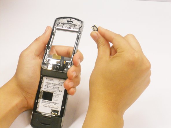

  6. Motorola MOTO W755 Cell Phone Speaker Replacement, Speaker: crwdns2935265:06crwdnd2935265:01crwdnd2935265:02crwdne2935265:0 Motorola MOTO W755 Cell Phone Speaker Replacement, Speaker: crwdns2935265:06crwdnd2935265:02crwdnd2935265:02crwdne2935265:0
    • Flip the top portion of the phone so that the back is facing you.
    • Using the flat end of the plastic opening tool, pry the speaker off the back of the phone.
