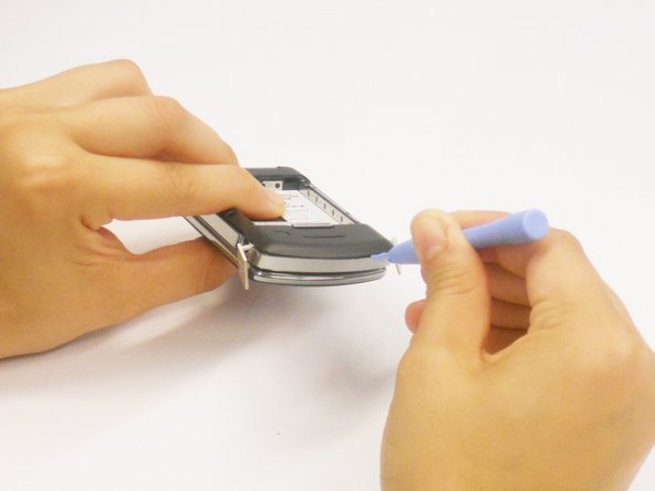

    • Using a plastic opening tool, carefully peel back the rubber strip located at the bottom of the keypad
    • Remove the two T5 Torx-screws underneath the rubber strip using the T5 Torx-screwdriver

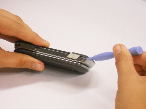

  3. Motorola MOTO W755 Cell Phone Functional Keypad Replacement: crwdns2935265:03crwdnd2935265:01crwdnd2935265:03crwdne2935265:0 Motorola MOTO W755 Cell Phone Functional Keypad Replacement: crwdns2935265:03crwdnd2935265:02crwdnd2935265:03crwdne2935265:0 Motorola MOTO W755 Cell Phone Functional Keypad Replacement: crwdns2935265:03crwdnd2935265:03crwdnd2935265:03crwdne2935265:0
    • Using the flat end of the plastic opening tool, insert it in the gap between the charging port and plastic at the bottom left side of the phone.
    • Slide the opening tool around the phone clockwise until you reach the audio port.
    • Twist the opening tool until the plastic pops off from the body of the phone. This make require a small amount of force.

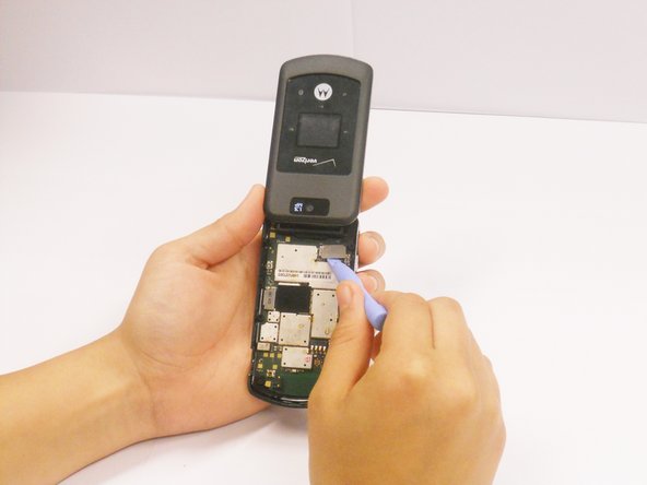

  5. Motorola MOTO W755 Cell Phone Functional Keypad Replacement: crwdns2935265:05crwdnd2935265:01crwdnd2935265:02crwdne2935265:0 Motorola MOTO W755 Cell Phone Functional Keypad Replacement: crwdns2935265:05crwdnd2935265:02crwdnd2935265:02crwdne2935265:0
    • Using the plastic opening tool, carefully unclip the cable ribbon from the main logic board. Be sure not to tear it because the flex is very fragile.
    • Remove the main logic board.
