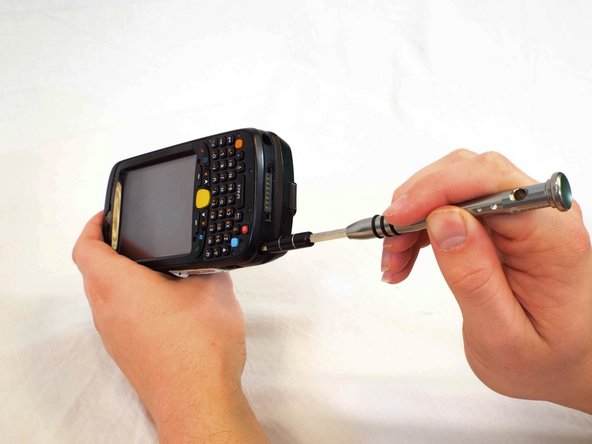

  4. Motorola MC5590 LCD Screen Replacement: crwdns2935265:04crwdnd2935265:01crwdnd2935265:03crwdne2935265:0 Motorola MC5590 LCD Screen Replacement: crwdns2935265:04crwdnd2935265:02crwdnd2935265:03crwdne2935265:0 Motorola MC5590 LCD Screen Replacement: crwdns2935265:04crwdnd2935265:03crwdnd2935265:03crwdne2935265:0
    • Remove the four 1cm Phillips #0 screws from the top and bottom of the phone.

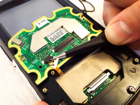

    • Use a spudger to flip up the retaining flap on the keyboard ribbon cable ZIF socket.
    • Pull the ribbon cable out of the socket.
  9. Motorola MC5590 LCD Screen Replacement: crwdns2935265:09crwdnd2935265:01crwdnd2935265:02crwdne2935265:0 Motorola MC5590 LCD Screen Replacement: crwdns2935265:09crwdnd2935265:02crwdnd2935265:02crwdne2935265:0
    • Use a spudger to flip up the retaining flap on the display ribbon cable ZIF socket.
    • Remove the keyboard from the device.

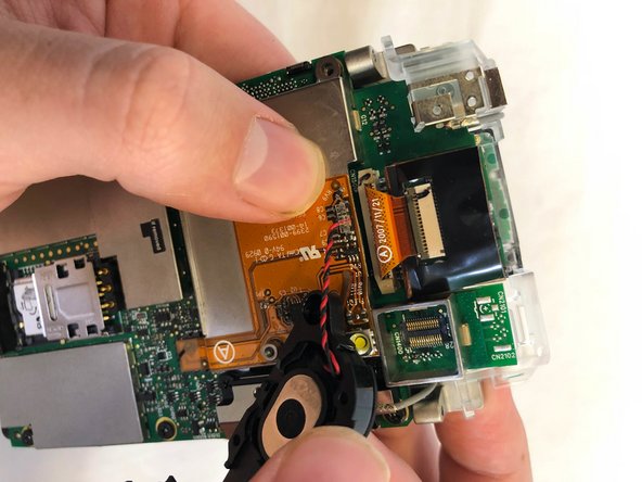

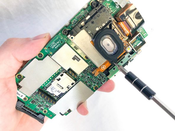

  13. Motorola MC5590 LCD Screen Replacement: crwdns2935265:013crwdnd2935265:01crwdnd2935265:02crwdne2935265:0 Motorola MC5590 LCD Screen Replacement: crwdns2935265:013crwdnd2935265:02crwdnd2935265:02crwdne2935265:0
    • Disconnect the speaker from the motherboard.
  14. Motorola MC5590 LCD Screen Replacement, LCD Screen: crwdns2935265:014crwdnd2935265:01crwdnd2935265:03crwdne2935265:0 Motorola MC5590 LCD Screen Replacement, LCD Screen: crwdns2935265:014crwdnd2935265:02crwdnd2935265:03crwdne2935265:0 Motorola MC5590 LCD Screen Replacement, LCD Screen: crwdns2935265:014crwdnd2935265:03crwdnd2935265:03crwdne2935265:0
    • Remove the the 3mm Phillips #00 screws from the flex cable cover and antenna.
    • Remove the antenna.
    • Remove the flex cable cover.

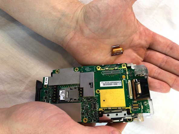

  15. Motorola MC5590 LCD Screen Replacement: crwdns2935265:015crwdnd2935265:01crwdnd2935265:02crwdne2935265:0 Motorola MC5590 LCD Screen Replacement: crwdns2935265:015crwdnd2935265:02crwdnd2935265:02crwdne2935265:0
    • Remove the five 3mm Phillips #00 screws from the motherboard.
  16. Motorola MC5590 LCD Screen Replacement: crwdns2935265:016crwdnd2935265:01crwdnd2935265:02crwdne2935265:0 Motorola MC5590 LCD Screen Replacement: crwdns2935265:016crwdnd2935265:02crwdnd2935265:02crwdne2935265:0
    • Remove the scanner ribbon cable by pulling straight up and out.
  17. Motorola MC5590 LCD Screen Replacement: crwdns2935265:017crwdnd2935265:01crwdnd2935265:02crwdne2935265:0 Motorola MC5590 LCD Screen Replacement: crwdns2935265:017crwdnd2935265:02crwdnd2935265:02crwdne2935265:0

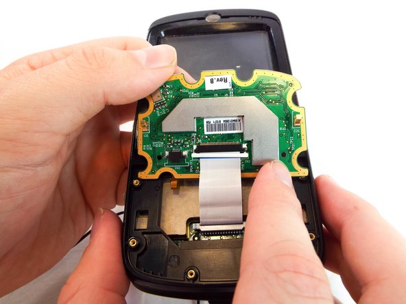

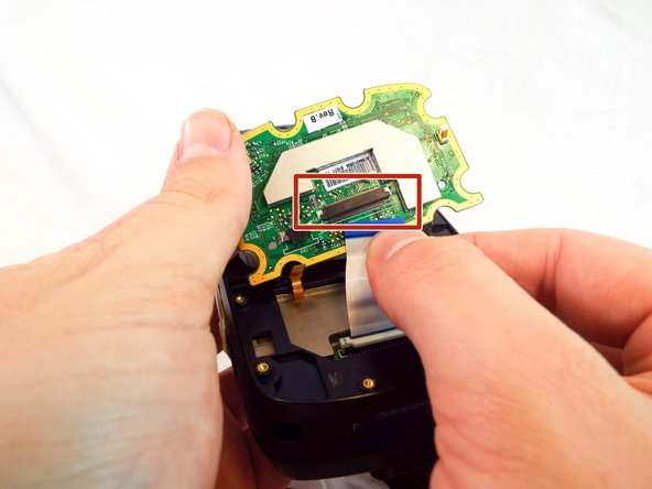

    • Flip open the motherboard and the LCD screen.
    • Open the LCD connector and remove the cable.
    • Pull the LCD Screen and its metal bracket apart.
