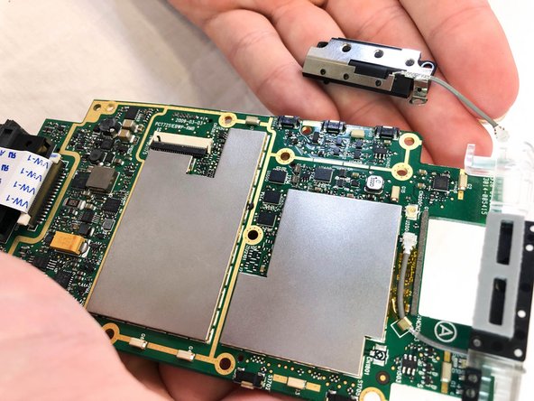

  18. Motorola MC5590 Internal Antenna Replacement, Internal Antenna: crwdns2935265:018crwdnd2935265:01crwdnd2935265:02crwdne2935265:0 Motorola MC5590 Internal Antenna Replacement, Internal Antenna: crwdns2935265:018crwdnd2935265:02crwdnd2935265:02crwdne2935265:0
    • Remove the antenna connector (red box).
    • This is a snap-on connector, which can be removed by applying a gentle pull straight up from the motherboard.
