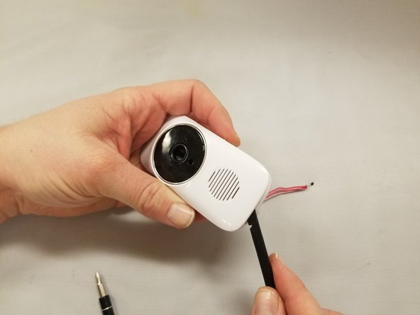

  6. Motorola MBP667CONNECT Speaker Replacement: crwdns2935265:06crwdnd2935265:01crwdnd2935265:02crwdne2935265:0 Motorola MBP667CONNECT Speaker Replacement: crwdns2935265:06crwdnd2935265:02crwdnd2935265:02crwdne2935265:0
    • Now, remove the bottom of the stand by pulling it from the camera.

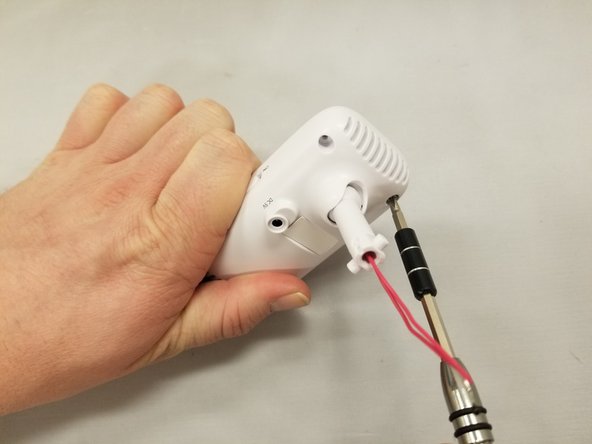

  7. Motorola MBP667CONNECT Speaker Replacement, Speaker: crwdns2935265:07crwdnd2935265:01crwdnd2935265:03crwdne2935265:0 Motorola MBP667CONNECT Speaker Replacement, Speaker: crwdns2935265:07crwdnd2935265:02crwdnd2935265:03crwdne2935265:0 Motorola MBP667CONNECT Speaker Replacement, Speaker: crwdns2935265:07crwdnd2935265:03crwdnd2935265:03crwdne2935265:0
    • Remove the Phillips #1 screws on the back of the device.
    • Use a nylon spudger to remove the casing. This will separate the frontside of the camera from the backside.

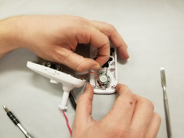

  8. Motorola MBP667CONNECT Speaker Replacement: crwdns2935265:08crwdnd2935265:01crwdnd2935265:02crwdne2935265:0 Motorola MBP667CONNECT Speaker Replacement: crwdns2935265:08crwdnd2935265:02crwdnd2935265:02crwdne2935265:0
    • Now locate the brackets by the speaker on the frontside of the camera and use the metal spudger to carefully disconnect from casing.
    • Continue to use the metal spudger to carefully disconnect the remaining brackets from the casing.

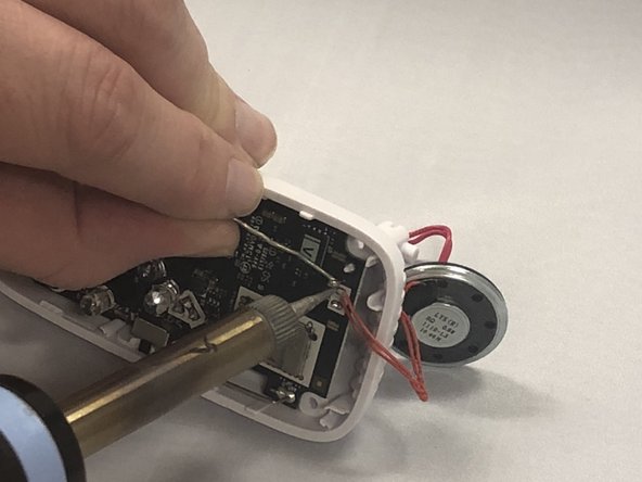

  9. Motorola MBP667CONNECT Speaker Replacement: crwdns2935265:09crwdnd2935265:01crwdnd2935265:02crwdne2935265:0 Motorola MBP667CONNECT Speaker Replacement: crwdns2935265:09crwdnd2935265:02crwdnd2935265:02crwdne2935265:0
    • Using the soldering iron, desolder the speaker wires that are attached to the circuit board.
    • Use caution while handling the soldering iron. This tool gets very hot!
    • After desoldering the speaker wires, remove the wires from the circuit board.
    • Thread the wires from the new speaker wires through the holes in the circuit board. Using the soldering iron, re-solder the wires to the circuit board.
