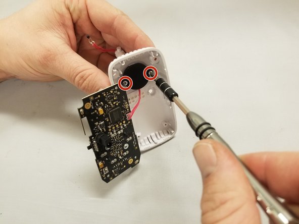

    • Remove the two 5 mm Phillips #1 screws on the back of the camera.
    • Use a nylon spudger to remove the casing.

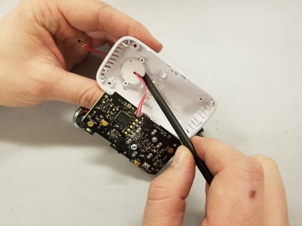

    • Use the nylon spudger to remove the circuit board from the plastic casing for the backside of the camera.
    • Remove the two 5 mm Phillips #1 screws on the black circle receiver housing.
    • Now that the black circle is detached, use a nylon spudger to remove the white plastic circle from the casing.

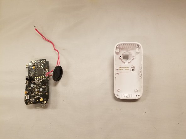

  4. Motorola MBP667CONNECT Circuit Board Replacement: crwdns2935265:04crwdnd2935265:01crwdnd2935265:02crwdne2935265:0 Motorola MBP667CONNECT Circuit Board Replacement: crwdns2935265:04crwdnd2935265:02crwdnd2935265:02crwdne2935265:0
    • You will now be able to carefully pull the receiver wire through the gap in the casing.
