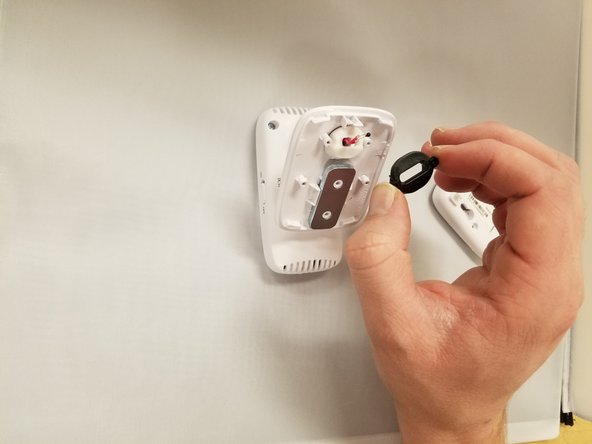

    • Remove two 5 mm Phillips #1 screws from the bottom of the camera stand.
  2. Motorola MBP667CONNECT Camera Stand Replacement: crwdns2935265:02crwdnd2935265:01crwdnd2935265:01crwdne2935265:0
    • Use a nylon spudger to remove the casing.
  3. Motorola MBP667CONNECT Camera Stand Replacement: crwdns2935265:03crwdnd2935265:01crwdnd2935265:01crwdne2935265:0
    • Remove the two 5 mm Phillips #1 screws attached to the black plastic under the casing.
  4. Motorola MBP667CONNECT Camera Stand Replacement: crwdns2935265:04crwdnd2935265:01crwdnd2935265:02crwdne2935265:0 Motorola MBP667CONNECT Camera Stand Replacement: crwdns2935265:04crwdnd2935265:02crwdnd2935265:02crwdne2935265:0
    • Remove the black circular plastic part.
  5. Motorola MBP667CONNECT Camera Stand Replacement: crwdns2935265:05crwdnd2935265:01crwdnd2935265:01crwdne2935265:0
    • Remove the white plastic wire housing beneath the black plastic.
  6. Motorola MBP667CONNECT Camera Stand Replacement: crwdns2935265:06crwdnd2935265:01crwdnd2935265:02crwdne2935265:0 Motorola MBP667CONNECT Camera Stand Replacement: crwdns2935265:06crwdnd2935265:02crwdnd2935265:02crwdne2935265:0
    • Now, remove the bottom of the stand by pulling it from the camera.
