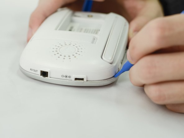

      • Using the Phillips #1 screwdriver, remove the 7mm screw under the battery cover.

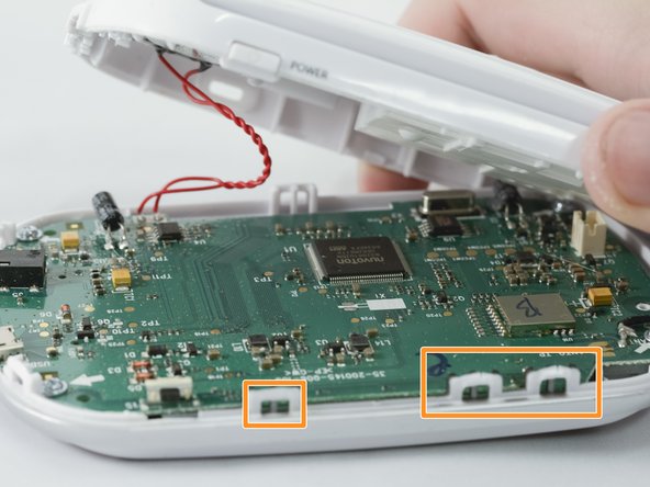

      • Using the blue plastic opening tools, begin prying open the corners and disconnecting the seven clasps around the edges of the parent unit.
      • There should be seven plastic clasps that hook the top portion of the plastic shell to the bottom, these clasps may become damaged while disassembling.

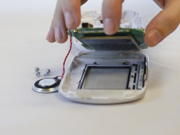

      • Using the Phillips #1 screwdriver, remove the 5.5mm screws holding the circuit board to the shell.
      • Lift the circuit board from the face of the shell, the back should still be connected by the antenna and the speaker.
      • The LCD Screen is glued to the circuit board by a protective foam layer. Attempts at removing the screen may result in damaged hardware.

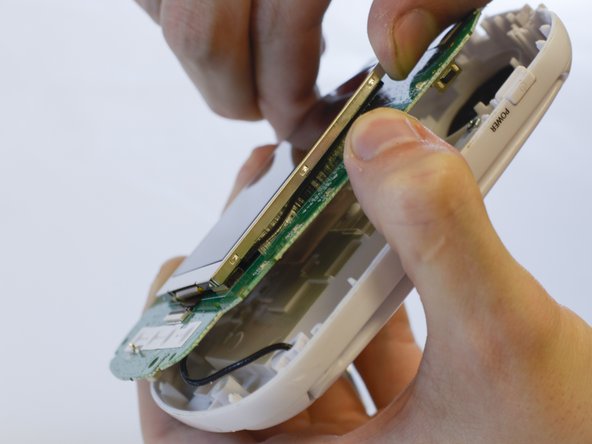

    3. Motorola MBP33SBU LCD Screen Replacement: crwdns2935265:05crwdnd2935265:01crwdnd2935265:03crwdne2935265:0 Motorola MBP33SBU LCD Screen Replacement: crwdns2935265:05crwdnd2935265:02crwdnd2935265:03crwdne2935265:0 Motorola MBP33SBU LCD Screen Replacement: crwdns2935265:05crwdnd2935265:03crwdnd2935265:03crwdne2935265:0

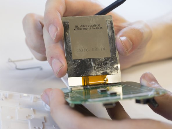

      • Using the flat end of the spudger tool, wedge the tool between the foam layer and the circuit board.
      • This might bend the metal frame around the screen out of place (don't worry about bending the metal, it is part of the screen being replaced).
      • Using the spudger and your fingers, pry the screen from the circuit board.

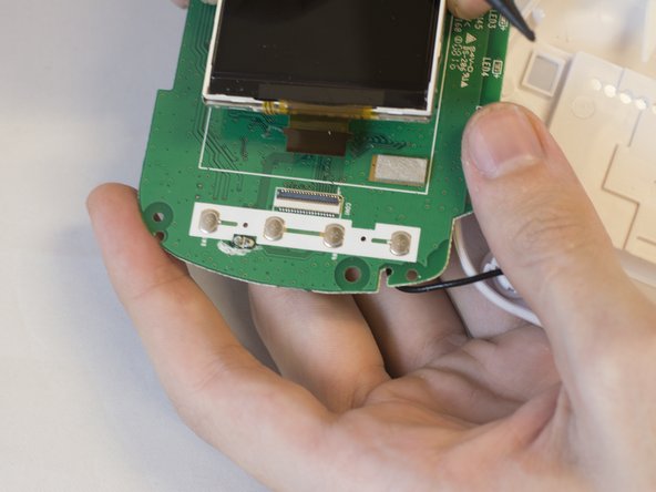

    4. Motorola MBP33SBU LCD Screen Replacement: crwdns2935265:06crwdnd2935265:01crwdnd2935265:02crwdne2935265:0 Motorola MBP33SBU LCD Screen Replacement: crwdns2935265:06crwdnd2935265:02crwdnd2935265:02crwdne2935265:0
      • There is a small black clasp that holds the circuit ribbon in place. The LCD screen can be removed without undoing the clasp but will need to be put back in place when installing the new screen.
      • Gripping the screen with your fingers, gently pull and wiggle back and fourth until the circuit ribbon detaches from the circuit board.
