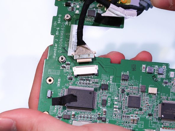

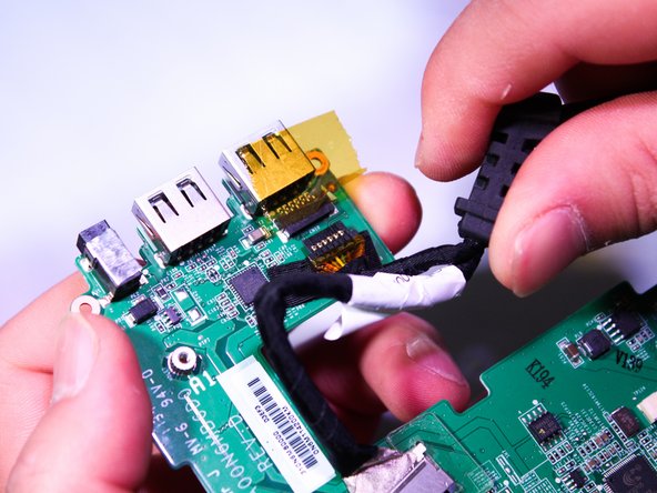

  10. Motorola Lapdock 100 Phone Adapter Cable Replacement, Phone Adapter Cable: crwdns2935265:010crwdnd2935265:01crwdnd2935265:03crwdne2935265:0 Motorola Lapdock 100 Phone Adapter Cable Replacement, Phone Adapter Cable: crwdns2935265:010crwdnd2935265:02crwdnd2935265:03crwdne2935265:0 Motorola Lapdock 100 Phone Adapter Cable Replacement, Phone Adapter Cable: crwdns2935265:010crwdnd2935265:03crwdnd2935265:03crwdne2935265:0
    • Unplug the two connections to the motherboard to free the adapter cable.
    • You do not need to remove the motherboard to remove the phone adapter cable. We did this for picture purposes only.
