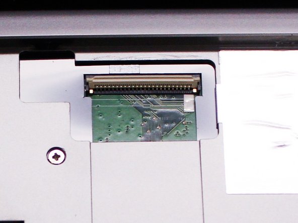

    • Flip up white clip holding the ribbon cable on the contact as shown in the two pictures and then gently disconnect the ribbon cable.
