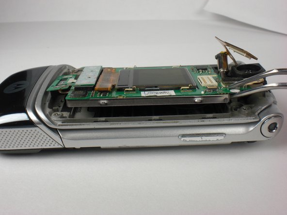

    • Gently use The Spudger towards the edge of the phone and lift the face plate off.
    • The touch-sensitive keys and chip board/LCD screen (which is green) may remain attached to the face plate because of the glue.
    • Gently hold the green logic board down as you lift the face plate apart from it.
    • Remove the face plate.
  4. Motorola Krzr K1m LCD Replacement: crwdns2935265:04crwdnd2935265:01crwdnd2935265:03crwdne2935265:0 Motorola Krzr K1m LCD Replacement: crwdns2935265:04crwdnd2935265:02crwdnd2935265:03crwdne2935265:0 Motorola Krzr K1m LCD Replacement: crwdns2935265:04crwdnd2935265:03crwdnd2935265:03crwdne2935265:0
    • Gently, with your fingers or a tweezer, lift the orange flex cable apart from the pin connector it is connected to.
    • Gently remove the green logic board/LCD (Liquid Crystal Display) screen away from the phone.
    • Replace with new green logic board/LCD screen.
    • To reassemble the phone, follow of the steps in reverse order.
