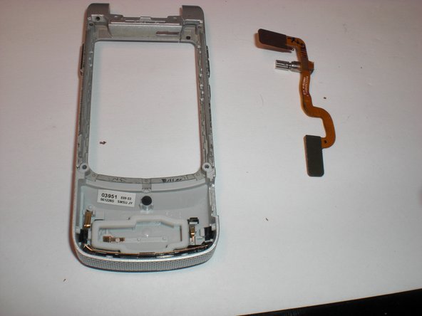

  8. Motorola Krzr K1m Flex Cable Replacement, Flex Cable: crwdns2935265:08crwdnd2935265:01crwdnd2935265:01crwdne2935265:0
    • Remove the small silver screw located where the top of the back of the phone.
  9. Motorola Krzr K1m Flex Cable Replacement: crwdns2935265:09crwdnd2935265:01crwdnd2935265:01crwdne2935265:0
    • Then take out the small grey plastic cap indicated in the picture.
    • do not lose the cap!

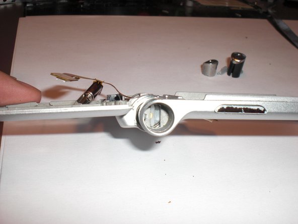

  10. Motorola Krzr K1m Flex Cable Replacement: crwdns2935265:010crwdnd2935265:01crwdnd2935265:02crwdne2935265:0 Motorola Krzr K1m Flex Cable Replacement: crwdns2935265:010crwdnd2935265:02crwdnd2935265:02crwdne2935265:0
    • Next, turn the frame on it's side and gently tap it till the hinge cover that was screwed in falls out.
    • Then use your flathead to push here. Be careful! Apply a little force but not too much or else the left hingecover you're pushing out here may shoot out and get lost.

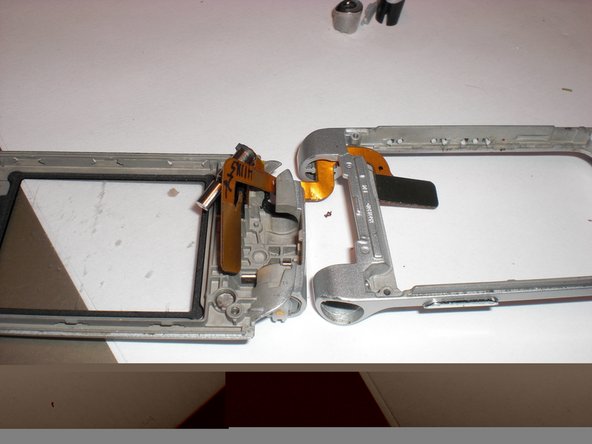

  11. Motorola Krzr K1m Flex Cable Replacement: crwdns2935265:011crwdnd2935265:01crwdnd2935265:02crwdne2935265:0 Motorola Krzr K1m Flex Cable Replacement: crwdns2935265:011crwdnd2935265:02crwdnd2935265:02crwdne2935265:0
    • Push in the white thing in the middle, it's spring-loaded, and pull the frame halves apart.
    • DO NOT LOSE THE BLACK HINGE RING. you need it.
  12. Motorola Krzr K1m Flex Cable Replacement: crwdns2935265:012crwdnd2935265:01crwdnd2935265:02crwdne2935265:0 Motorola Krzr K1m Flex Cable Replacement: crwdns2935265:012crwdnd2935265:02crwdnd2935265:02crwdne2935265:0
    • Then slide out the flex cable.
    • Slide in the new flex cable the same way you took it out.
    • And congratulations you are done!
