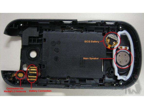

    • We gave the Motorola Krave a spin and - of course - a good tearing down.
    • This phone was actually even more of a pain to open than the Nokia N95. This is due to the multiple layers and multiple connections made. Shielding was an issue, but wire snippers made quick work of that.
    • Not only is there one main touchscreen, the cover also contains a capacitive circuit.
  2. Motorola Krave Teardown: crwdns2935265:02crwdnd2935265:01crwdnd2935265:03crwdne2935265:0 Motorola Krave Teardown: crwdns2935265:02crwdnd2935265:02crwdnd2935265:03crwdne2935265:0 Motorola Krave Teardown: crwdns2935265:02crwdnd2935265:03crwdnd2935265:03crwdne2935265:0
    • A unique feature (with questionable practicality) is the device’s ability to use the touchscreen with the clear plastic cover closed. The way this is implemented is through an ingenious, thin mesh that’s able to sense your fingers position.
    • The mesh is actually used to transmit power and signals to the earpiece, as there is no other connection to it, which brings us to the second unique feature.
    • The Krave’s earpiece is made to appear wireless. It’s a very interesting concept and it definitely has its appeals.
