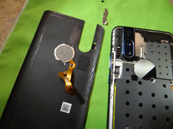

  1. Motorola Hyper Android Phone Charging port Replacement, Finding the seam  to remove.: crwdns2935265:01crwdnd2935265:01crwdnd2935265:01crwdne2935265:0
    • Charging port replacement
  2. Motorola Hyper Android Phone Charging port Replacement, Teardown - Remove sim tray: crwdns2935265:02crwdnd2935265:01crwdnd2935265:03crwdne2935265:0 Motorola Hyper Android Phone Charging port Replacement, Teardown - Remove sim tray: crwdns2935265:02crwdnd2935265:02crwdnd2935265:03crwdne2935265:0 Motorola Hyper Android Phone Charging port Replacement, Teardown - Remove sim tray: crwdns2935265:02crwdnd2935265:03crwdnd2935265:03crwdne2935265:0

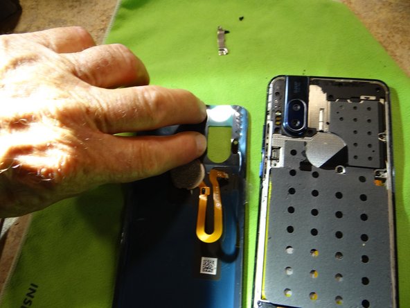

    • Use a heat gun or hair dryer to soften the adhesive on the rear cover
  3. Motorola Hyper Android Phone Charging port Replacement: crwdns2935265:03crwdnd2935265:01crwdnd2935265:03crwdne2935265:0 Motorola Hyper Android Phone Charging port Replacement: crwdns2935265:03crwdnd2935265:02crwdnd2935265:03crwdne2935265:0 Motorola Hyper Android Phone Charging port Replacement: crwdns2935265:03crwdnd2935265:03crwdnd2935265:03crwdne2935265:0
    • Start at the camera and go around the edge with an Opening Pick. Pry the last bit around the camera.
  4. Motorola Hyper Android Phone Charging port Replacement, Opening cover: crwdns2935265:04crwdnd2935265:01crwdnd2935265:03crwdne2935265:0 Motorola Hyper Android Phone Charging port Replacement, Opening cover: crwdns2935265:04crwdnd2935265:02crwdnd2935265:03crwdne2935265:0 Motorola Hyper Android Phone Charging port Replacement, Opening cover: crwdns2935265:04crwdnd2935265:03crwdnd2935265:03crwdne2935265:0

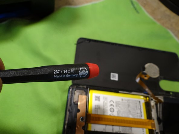

    • Open case from the on button side face down. You will need a T4 bit driver.
  5. Motorola Hyper Android Phone Charging port Replacement, Remove  screws for vent: crwdns2935265:05crwdnd2935265:01crwdnd2935265:03crwdne2935265:0 Motorola Hyper Android Phone Charging port Replacement, Remove  screws for vent: crwdns2935265:05crwdnd2935265:02crwdnd2935265:03crwdne2935265:0 Motorola Hyper Android Phone Charging port Replacement, Remove  screws for vent: crwdns2935265:05crwdnd2935265:03crwdnd2935265:03crwdne2935265:0

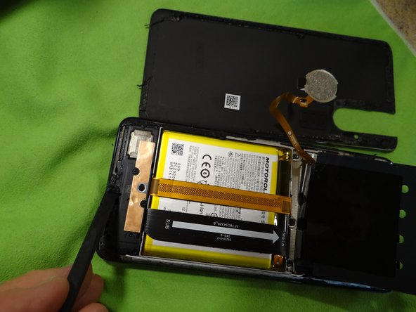

    • Remove 6 T4 screws. Remove mini fan vent.
  6. Motorola Hyper Android Phone Charging port Replacement, Remove charging wires: crwdns2935265:06crwdnd2935265:01crwdnd2935265:03crwdne2935265:0 Motorola Hyper Android Phone Charging port Replacement, Remove charging wires: crwdns2935265:06crwdnd2935265:02crwdnd2935265:03crwdne2935265:0 Motorola Hyper Android Phone Charging port Replacement, Remove charging wires: crwdns2935265:06crwdnd2935265:03crwdnd2935265:03crwdne2935265:0
    • Pry off the black and white wires with a pry tool. Remove Philips screw.
  7. Motorola Hyper Android Phone Charging port Replacement, Remove charge port: crwdns2935265:07crwdnd2935265:01crwdnd2935265:03crwdne2935265:0 Motorola Hyper Android Phone Charging port Replacement, Remove charge port: crwdns2935265:07crwdnd2935265:02crwdnd2935265:03crwdne2935265:0 Motorola Hyper Android Phone Charging port Replacement, Remove charge port: crwdns2935265:07crwdnd2935265:03crwdnd2935265:03crwdne2935265:0
    • Remove and replace the charge port with new one.

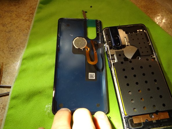

  9. Motorola Hyper Android Phone Charging port Replacement, Remove old gasket material: crwdns2935265:09crwdnd2935265:01crwdnd2935265:03crwdne2935265:0 Motorola Hyper Android Phone Charging port Replacement, Remove old gasket material: crwdns2935265:09crwdnd2935265:02crwdnd2935265:03crwdne2935265:0 Motorola Hyper Android Phone Charging port Replacement, Remove old gasket material: crwdns2935265:09crwdnd2935265:03crwdnd2935265:03crwdne2935265:0
    • Clean all the gasket off.
    • There is only room for one layer, for a smooth cover fit.
  10. Motorola Hyper Android Phone Charging port Replacement, Remove finger print reader cable: crwdns2935265:010crwdnd2935265:01crwdnd2935265:03crwdne2935265:0 Motorola Hyper Android Phone Charging port Replacement, Remove finger print reader cable: crwdns2935265:010crwdnd2935265:02crwdnd2935265:03crwdne2935265:0 Motorola Hyper Android Phone Charging port Replacement, Remove finger print reader cable: crwdns2935265:010crwdnd2935265:03crwdnd2935265:03crwdne2935265:0
    • Remove finger print reader cable to install new cover gasket. surface must be clean so the cover sits tight with no gaps.
