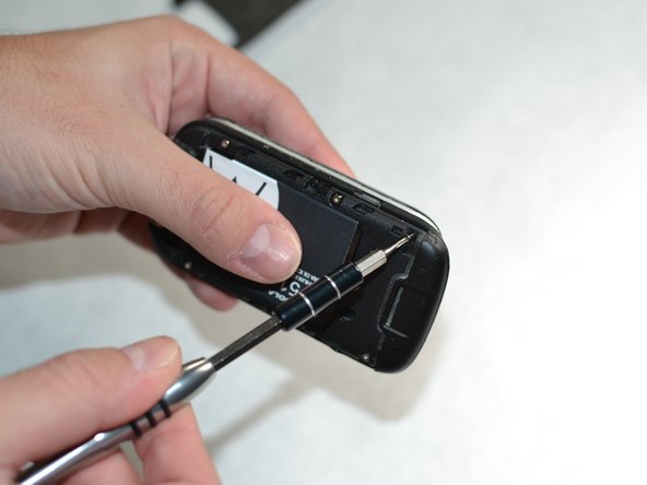

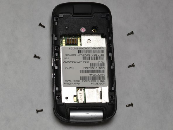

    • The six screws need to be taken out with any conventional screw driver tool.
    • You will have to unscrew the six 5.31 mm Star Head #5 screws with the appropriate six star bit.
    • There should be six screws removed from the casing after completion.

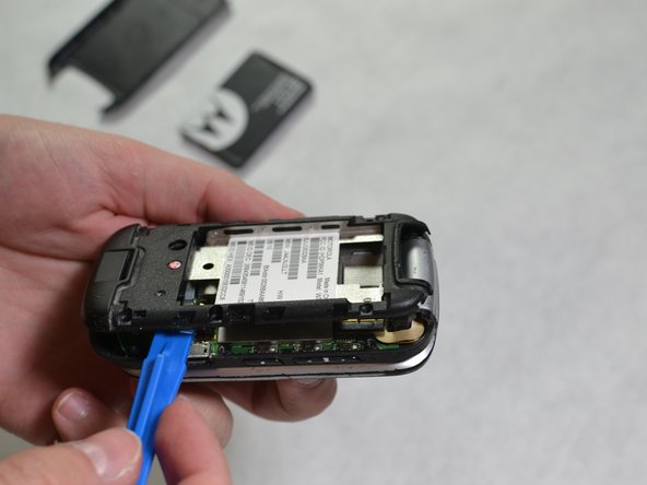

    • First you will need to locate the lip on the left side of the device.
    • Next you will insert the black spudger firmly into side opening to loosen the casing.
    • Using the blue pry tool gently remove the black and silver casing.

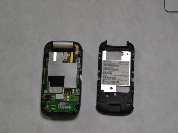

    • The motherboard should then be exposed after removal.

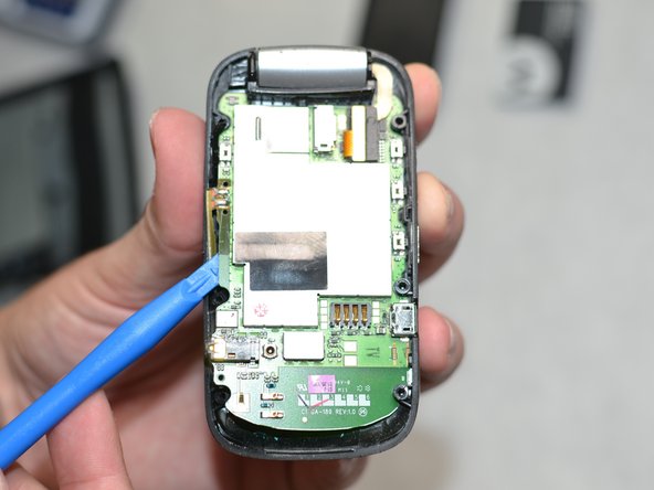

    • Remove the flex cable with a pair of tweezers.
    • Be gentle with the flex cable as not to break the connecting wire.

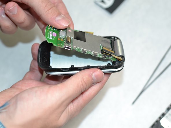

    • Now use a spudger or pry tool to place firmly under the motherboard.
    • After creating clearance with the spudging device grab and remove the motherboard with a clamping tool or hand.
    • Look at the motherboard for scorches or loose pieces which could indicate damage.
    • Refer to the troubleshooting page for further advice to replace the motherboard.
