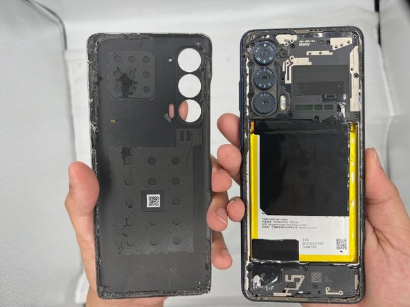

    • Remove the back cover of the smartphone.
  2. Motorola Edge (2021) Front-Facing Camera module Replacement: crwdns2935265:02crwdnd2935265:01crwdnd2935265:01crwdne2935265:0

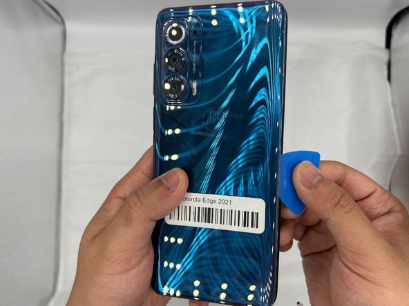

    • Use two iOpeners to heat up the glue beneath the back-plate.
  3. Motorola Edge (2021) Front-Facing Camera module Replacement: crwdns2935265:03crwdnd2935265:01crwdnd2935265:03crwdne2935265:0 Motorola Edge (2021) Front-Facing Camera module Replacement: crwdns2935265:03crwdnd2935265:02crwdnd2935265:03crwdne2935265:0 Motorola Edge (2021) Front-Facing Camera module Replacement: crwdns2935265:03crwdnd2935265:03crwdnd2935265:03crwdne2935265:0
    • Wedge the iFixit Opening Pick in between the cracks of the smartphone's backplate.
    • Slide the opening tool along the sides of the phone until the glue is separated from the back-plate.

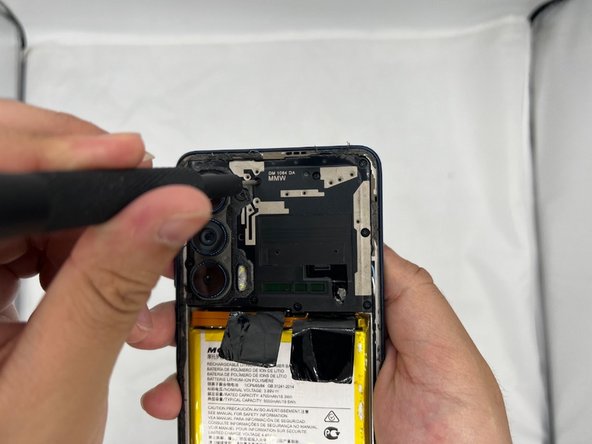

    • Next, use the Phillips #00 Screwdriver to unscrew the motherboard/camera casing. Be sure to check under the glue for any unseen screws.
  5. Motorola Edge (2021) Front-Facing Camera module Replacement: crwdns2935265:05crwdnd2935265:01crwdnd2935265:02crwdne2935265:0 Motorola Edge (2021) Front-Facing Camera module Replacement: crwdns2935265:05crwdnd2935265:02crwdnd2935265:02crwdne2935265:0
    • After you're done unscrewing, use the iFixit Opening Tool to carefully pry open the casing.

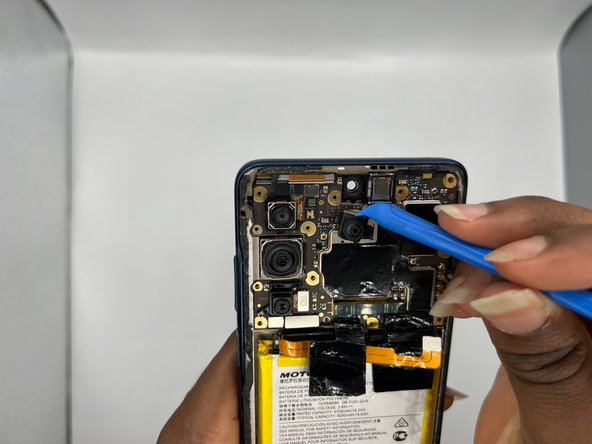

  6. Motorola Edge (2021) Front-Facing Camera module Replacement: crwdns2935265:06crwdnd2935265:01crwdnd2935265:01crwdne2935265:0
    • This is the front facing camera module.
  7. Motorola Edge (2021) Front-Facing Camera module Replacement: crwdns2935265:07crwdnd2935265:01crwdnd2935265:02crwdne2935265:0 Motorola Edge (2021) Front-Facing Camera module Replacement: crwdns2935265:07crwdnd2935265:02crwdnd2935265:02crwdne2935265:0
    • Using the iFixit Opening Tool, carefully remove the camera module.

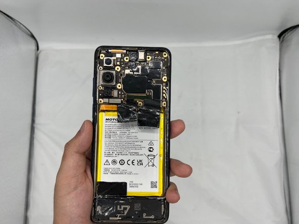

  8. Motorola Edge (2021) Front-Facing Camera module Replacement: crwdns2935265:08crwdnd2935265:01crwdnd2935265:01crwdne2935265:0
    • Congratulations, you have successfully removed the front facing camera module for your Motorola Edge.
