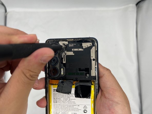

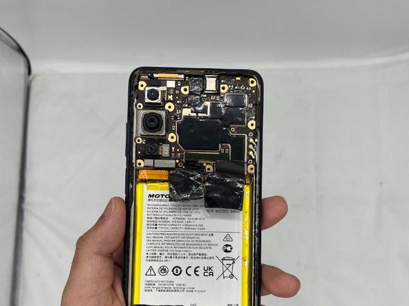

  4. Motorola Edge (2021) Camera module Replacement: crwdns2935265:04crwdnd2935265:01crwdnd2935265:02crwdne2935265:0 Motorola Edge (2021) Camera module Replacement: crwdns2935265:04crwdnd2935265:02crwdnd2935265:02crwdne2935265:0
    • Now you need to uncrews the camera/motherboard casing.
    • Unscrew all the screws under the circles. Be careful not to miss a screw that might be hiding under the glue.
  5. Motorola Edge (2021) Camera module Replacement: crwdns2935265:05crwdnd2935265:01crwdnd2935265:02crwdne2935265:0 Motorola Edge (2021) Camera module Replacement: crwdns2935265:05crwdnd2935265:02crwdnd2935265:02crwdne2935265:0
    • Use the iFixit prying tool to gently slide the camera casing off the phone. Be careful not to damage the motherboard underneath.
