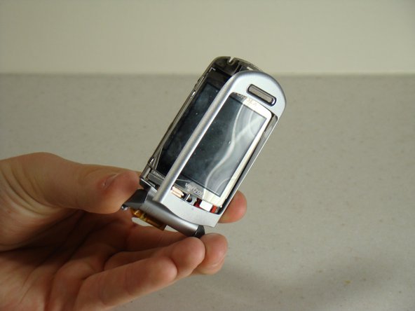

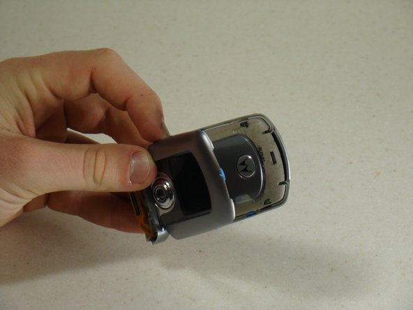

  9. Motorola E815 interiorscreen replacement: crwdns2935265:09crwdnd2935265:01crwdnd2935265:01crwdne2935265:0
    • Rotate the top section of the phone around so that you are looking at the outer screen.
    • Disconnect the cover from the outer screen side of the phone.
  10. Motorola E815 interiorscreen replacement: crwdns2935265:010crwdnd2935265:01crwdnd2935265:03crwdne2935265:0 Motorola E815 interiorscreen replacement: crwdns2935265:010crwdnd2935265:02crwdnd2935265:03crwdne2935265:0 Motorola E815 interiorscreen replacement: crwdns2935265:010crwdnd2935265:03crwdnd2935265:03crwdne2935265:0
    • Rotate the top section of the phone around so you are looking at the large screen.
    • Using your fingers, lift the protector off of the screen.

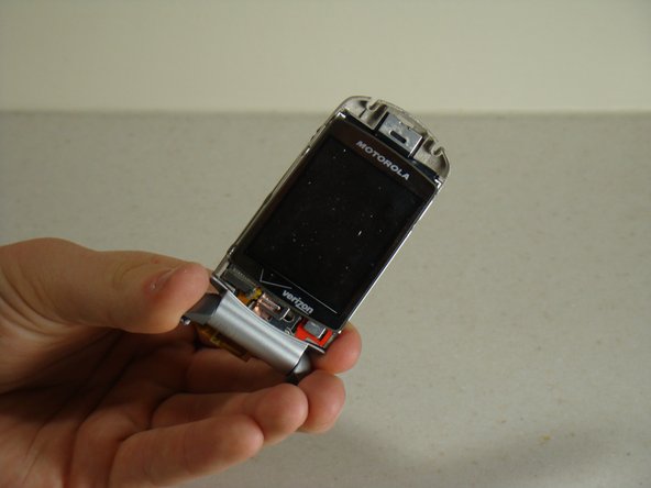

  11. Motorola E815 interiorscreen replacement: crwdns2935265:011crwdnd2935265:01crwdnd2935265:01crwdne2935265:0
    • Using the blue pry tool, gently remove the screen cover.
    • Since it is glued into place, it may take some maneuvering to remove.
  12. Motorola E815 interiorscreen replacement: crwdns2935265:012crwdnd2935265:01crwdnd2935265:03crwdne2935265:0 Motorola E815 interiorscreen replacement: crwdns2935265:012crwdnd2935265:02crwdnd2935265:03crwdne2935265:0 Motorola E815 interiorscreen replacement: crwdns2935265:012crwdnd2935265:03crwdnd2935265:03crwdne2935265:0
    • Turn the phone so that you can see the side metal clasps.
    • Using the blue lifter tool, snap the metal clasps off of screen body.
    • Proceed to snap all four corners of the metal cover off of the screen body.
  13. Motorola E815 interiorscreen replacement: crwdns2935265:013crwdnd2935265:01crwdnd2935265:02crwdne2935265:0 Motorola E815 interiorscreen replacement: crwdns2935265:013crwdnd2935265:02crwdnd2935265:02crwdne2935265:0
    • Using tweezers, gently detach the brown connecting strip from the back of the screen.
    • Separate the screen from the phone frame.
    • The front screen can now be accessed and replaced!
  14. Motorola E815 interiorscreen replacement, Inside Screen: crwdns2935265:014crwdnd2935265:01crwdnd2935265:01crwdne2935265:0
    • The inside screen can now be accessed for repair or replacement!
