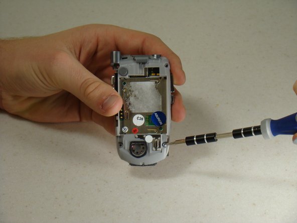

  6. Motorola E815 Keypad Replacement, Keypad: crwdns2935265:06crwdnd2935265:01crwdnd2935265:01crwdne2935265:0
    • Locate the two screws on the backside of the phone.
    • Unscrew the two screws using a T6 Screwdriver.

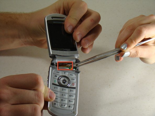

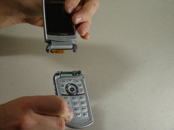

  7. Motorola E815 Keypad Replacement: crwdns2935265:07crwdnd2935265:01crwdnd2935265:03crwdne2935265:0 Motorola E815 Keypad Replacement: crwdns2935265:07crwdnd2935265:02crwdnd2935265:03crwdne2935265:0 Motorola E815 Keypad Replacement: crwdns2935265:07crwdnd2935265:03crwdnd2935265:03crwdne2935265:0
    • Gently pull the top section of the phone upwards until you feel some resistance.
    • Locate the brown connector that runs from the top section of the phone to the circuit board under the keypad.
    • Using tweezers, gently pry the connector from the circuit board.
    • Carefully detach the two sections of the phone.

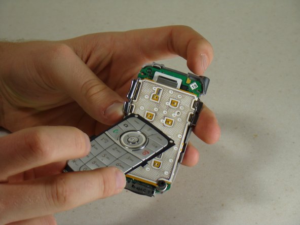

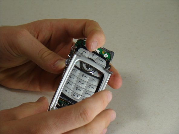

  8. Motorola E815 Keypad Replacement: crwdns2935265:08crwdnd2935265:01crwdnd2935265:03crwdne2935265:0 Motorola E815 Keypad Replacement: crwdns2935265:08crwdnd2935265:02crwdnd2935265:03crwdne2935265:0 Motorola E815 Keypad Replacement: crwdns2935265:08crwdnd2935265:03crwdnd2935265:03crwdne2935265:0
    • Using the blue pry tool, carefully pull the keypad frame away from the keypad.
    • Gently remove the keypad frame from the keypad.
    • Lift the silicone keypad cover off.
  9. Motorola E815 Keypad Replacement: crwdns2935265:09crwdnd2935265:01crwdnd2935265:02crwdne2935265:0 Motorola E815 Keypad Replacement: crwdns2935265:09crwdnd2935265:02crwdnd2935265:02crwdne2935265:0
    • Rotate the phone around so that you are looking at the battery cavity.
    • Locate the screws on the bottom base of the phone.

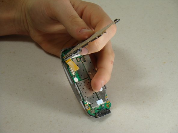

  10. Motorola E815 Keypad Replacement: crwdns2935265:010crwdnd2935265:01crwdnd2935265:02crwdne2935265:0 Motorola E815 Keypad Replacement: crwdns2935265:010crwdnd2935265:02crwdnd2935265:02crwdne2935265:0
    • Rotate the phone back to the front side.
    • Slowly lift the bottom portion of the keypad off of the phone until you feel resistance.

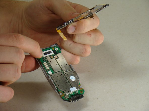

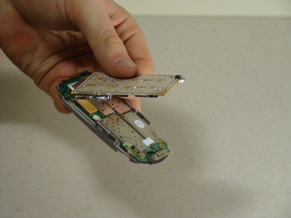

  11. Motorola E815 Keypad Replacement: crwdns2935265:011crwdnd2935265:01crwdnd2935265:03crwdne2935265:0 Motorola E815 Keypad Replacement: crwdns2935265:011crwdnd2935265:02crwdnd2935265:03crwdne2935265:0 Motorola E815 Keypad Replacement: crwdns2935265:011crwdnd2935265:03crwdnd2935265:03crwdne2935265:0
    • Using tweezers, carefully detach the yellow connector strip from the circuit board by lifting up.
    • Separate the keypad from the circuit board.
