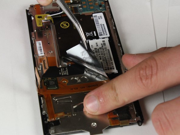

    • Using tweezers, peel back the black safety information sticker.
  25. Motorola Droid X LCD and Digitizer Replacement: crwdns2935265:025crwdnd2935265:01crwdnd2935265:01crwdne2935265:0
    • Using tweezers, peel the orange and black cable away from the device, stopping before reaching the electrical tape at the near the edge of the screen.
