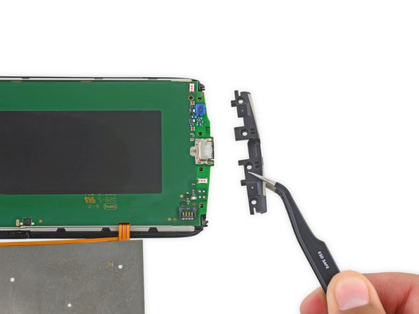

    • Remove the four Torx T5 screws securing the lower antenna board to the motherboard.
  10. Motorola Droid Turbo Rear Facing Camera Replacement: crwdns2935265:010crwdnd2935265:01crwdnd2935265:02crwdne2935265:0 Motorola Droid Turbo Rear Facing Camera Replacement: crwdns2935265:010crwdnd2935265:02crwdnd2935265:02crwdne2935265:0
    • Remove the lower antenna board.

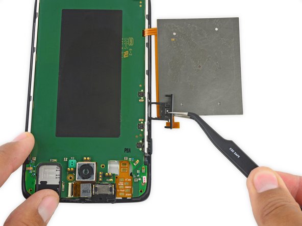

    • Remove the SIM card holder/volume button rocker.
  12. Motorola Droid Turbo Rear Facing Camera Replacement: crwdns2935265:012crwdnd2935265:01crwdnd2935265:02crwdne2935265:0 Motorola Droid Turbo Rear Facing Camera Replacement: crwdns2935265:012crwdnd2935265:02crwdnd2935265:02crwdne2935265:0

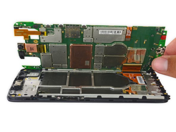

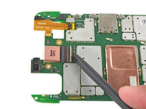

    • Carefully lift up the motherboard to expose the display connector.

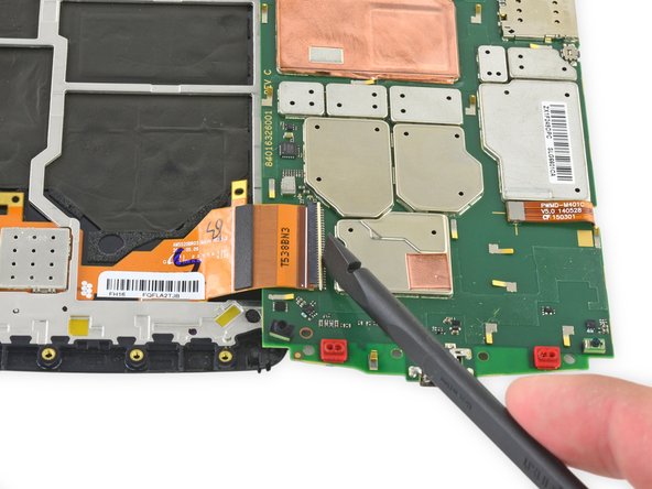

  13. Motorola Droid Turbo Rear Facing Camera Replacement: crwdns2935265:013crwdnd2935265:01crwdnd2935265:02crwdne2935265:0 Motorola Droid Turbo Rear Facing Camera Replacement: crwdns2935265:013crwdnd2935265:02crwdnd2935265:02crwdne2935265:0
    • Use the flat end of a spudger to flip up the retaining flap on the display ZIF connector.
    • Pull the display ribbon cable free of the connector.
    • Disconnecting the display ribbon cable makes it easier to remove the rear-facing camera, but it is not strictly necessary.

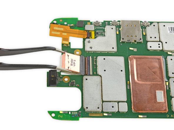

  14. Motorola Droid Turbo Rear Facing Camera Replacement: crwdns2935265:014crwdnd2935265:01crwdnd2935265:02crwdne2935265:0 Motorola Droid Turbo Rear Facing Camera Replacement: crwdns2935265:014crwdnd2935265:02crwdnd2935265:02crwdne2935265:0
    • Use the flat end of a spudger to flip up the black retaining flap on the front-facing camera ZIF connector.
    • Removing the front-facing camera makes it easier to remove the rear-facing camera, but it is not strictly necessary.

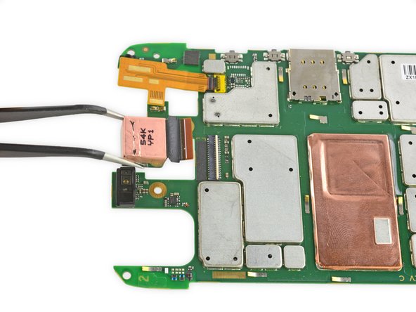

  15. Motorola Droid Turbo Rear Facing Camera Replacement: crwdns2935265:015crwdnd2935265:01crwdnd2935265:02crwdne2935265:0 Motorola Droid Turbo Rear Facing Camera Replacement: crwdns2935265:015crwdnd2935265:02crwdnd2935265:02crwdne2935265:0
    • Remove the front-facing camera.

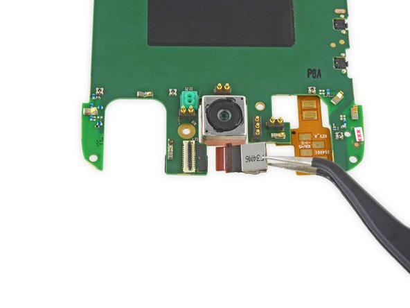

  16. Motorola Droid Turbo Rear Facing Camera Replacement: crwdns2935265:016crwdnd2935265:01crwdnd2935265:02crwdne2935265:0 Motorola Droid Turbo Rear Facing Camera Replacement: crwdns2935265:016crwdnd2935265:02crwdnd2935265:02crwdne2935265:0

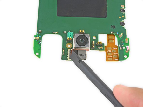

    • Use the flat end of a spudger to flip up the tan retaining flap on the rear-facing camera ZIF connector.
  17. Motorola Droid Turbo Rear Facing Camera Replacement: crwdns2935265:017crwdnd2935265:01crwdnd2935265:03crwdne2935265:0 Motorola Droid Turbo Rear Facing Camera Replacement: crwdns2935265:017crwdnd2935265:02crwdnd2935265:03crwdne2935265:0 Motorola Droid Turbo Rear Facing Camera Replacement: crwdns2935265:017crwdnd2935265:03crwdnd2935265:03crwdne2935265:0
    • Remove the rear-facing camera.

Nice tut. However, I couldn't remove the 2 screws on the side of the USB connector. They seem to be rotating loosely with a trembling sound. Any ideas how to remove it?.
vdamiani - crwdns2934203:0crwdne2934203:0
They’re not turning in the second section. The screw is just stuck in the black piece. Try using very pointed tweezers to help remove the screws. Put the points just underneath the screw head and hold it up as you unscrew it.
