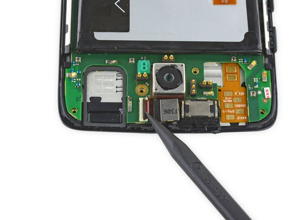

  6. Motorola Droid Turbo Front Facing Camera Replacement, Front Facing Camera: crwdns2935265:06crwdnd2935265:01crwdnd2935265:02crwdne2935265:0 Motorola Droid Turbo Front Facing Camera Replacement, Front Facing Camera: crwdns2935265:06crwdnd2935265:02crwdnd2935265:02crwdne2935265:0
    • Use the pointed end of a spudger to flip up the black retaining flap of the front facing camera's ZIF connector.
  7. Motorola Droid Turbo Front Facing Camera Replacement: crwdns2935265:07crwdnd2935265:01crwdnd2935265:02crwdne2935265:0 Motorola Droid Turbo Front Facing Camera Replacement: crwdns2935265:07crwdnd2935265:02crwdnd2935265:02crwdne2935265:0
    • Remove the front-facing camera.
