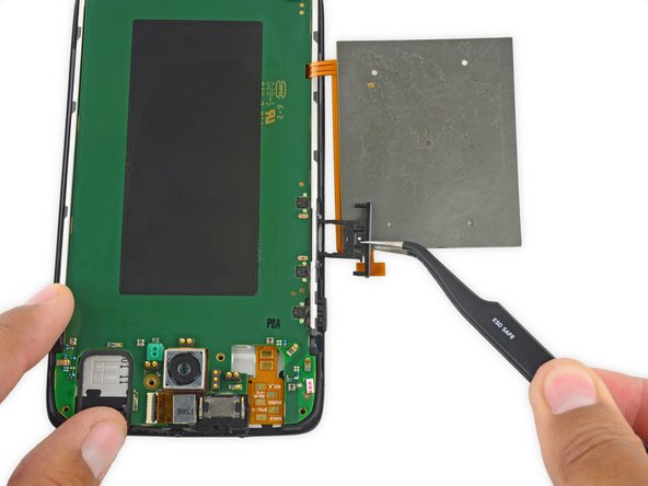

  10. Motorola Droid Turbo Display Assembly Replacement, Display Assembly: crwdns2935265:010crwdnd2935265:01crwdnd2935265:01crwdne2935265:0
    • Remove the four Torx T5 screws securing the lower antenna board to the motherboard.
  11. Motorola Droid Turbo Display Assembly Replacement: crwdns2935265:011crwdnd2935265:01crwdnd2935265:02crwdne2935265:0 Motorola Droid Turbo Display Assembly Replacement: crwdns2935265:011crwdnd2935265:02crwdnd2935265:02crwdne2935265:0
    • Remove the lower antenna board.
  12. Motorola Droid Turbo Display Assembly Replacement: crwdns2935265:012crwdnd2935265:01crwdnd2935265:02crwdne2935265:0 Motorola Droid Turbo Display Assembly Replacement: crwdns2935265:012crwdnd2935265:02crwdnd2935265:02crwdne2935265:0
    • Remove the SIM card holder/volume button rocker.
  13. Motorola Droid Turbo Display Assembly Replacement: crwdns2935265:013crwdnd2935265:01crwdnd2935265:02crwdne2935265:0 Motorola Droid Turbo Display Assembly Replacement: crwdns2935265:013crwdnd2935265:02crwdnd2935265:02crwdne2935265:0
    • Carefully lift up the motherboard to expose the display connector.
  14. Motorola Droid Turbo Display Assembly Replacement: crwdns2935265:014crwdnd2935265:01crwdnd2935265:02crwdne2935265:0 Motorola Droid Turbo Display Assembly Replacement: crwdns2935265:014crwdnd2935265:02crwdnd2935265:02crwdne2935265:0
    • Use the flat end of a spudger to flip up the retaining flap on the display ZIF connector.
    • Pull the display ribbon cable free of the connector.

This has a bunch of unecessary steps and is missing so,e just kinda bricked my phone thanks to this
fake name - crwdns2934203:0crwdne2934203:0
Yep. It repeats a bunch of steps, and seems to switch from replacing the display to replacing the motherboard. :(

You don’t need to remove the battery from the board…the whole thing comes up as one.
