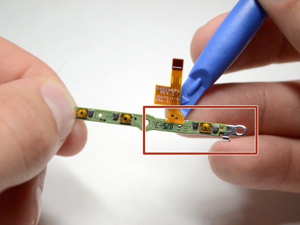

    1. Motorola Droid RAZR HD Power Button Replacement, Power Button: crwdns2935265:015crwdnd2935265:01crwdnd2935265:01crwdne2935265:0
      • Remove the three 3.5mm Torx T3 screws holding the power/volume button cable to the side of the frame.
    2. Motorola Droid RAZR HD Power Button Replacement: crwdns2935265:016crwdnd2935265:01crwdnd2935265:02crwdne2935265:0 Motorola Droid RAZR HD Power Button Replacement: crwdns2935265:016crwdnd2935265:02crwdnd2935265:02crwdne2935265:0
      • Using tweezers, remove the power/volume button flex cable.
      • Remove the flex cable from the metal bracket using a plastic opening tool.
