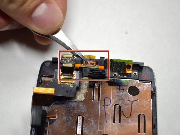

    1. Motorola Droid RAZR HD Front Panel Replacement, Front Panel: crwdns2935265:06crwdnd2935265:01crwdnd2935265:02crwdne2935265:0 Motorola Droid RAZR HD Front Panel Replacement, Front Panel: crwdns2935265:06crwdnd2935265:02crwdnd2935265:02crwdne2935265:0
      • Remove the two 2.0mm T4 Torx screws near the top of the screen.
      • Remove the metal plate protecting the front camera and ear speaker with tweezers.

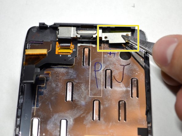

    2. Motorola Droid RAZR HD Front Panel Replacement: crwdns2935265:07crwdnd2935265:01crwdnd2935265:02crwdne2935265:0 Motorola Droid RAZR HD Front Panel Replacement: crwdns2935265:07crwdnd2935265:02crwdnd2935265:02crwdne2935265:0
      • Using a plastic openining tool, lift up the front camera and ear speaker assembly.
      • Remove the assembly with tweezers.
