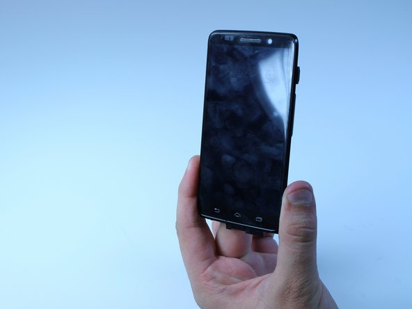

    • Pull out the volume keys using the iFixit opening tool.
  2. Motorola Droid Mini Front screen Replacement: crwdns2935265:02crwdnd2935265:01crwdnd2935265:02crwdne2935265:0 Motorola Droid Mini Front screen Replacement: crwdns2935265:02crwdnd2935265:02crwdnd2935265:02crwdne2935265:0
    • Pry off the back case gently using the iFixit opening tool.
    • Make sure to go around the entire perimeter of the case.
  3. Motorola Droid Mini Front screen Replacement, Front screen: crwdns2935265:03crwdnd2935265:01crwdnd2935265:02crwdne2935265:0 Motorola Droid Mini Front screen Replacement, Front screen: crwdns2935265:03crwdnd2935265:02crwdnd2935265:02crwdne2935265:0

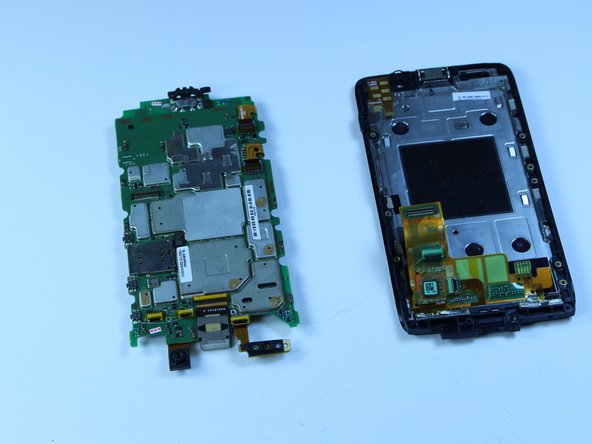

    • Use the T5 screw head to unscrew the 9 silver screws from the housing frame. Carefully separate the housing frame from the motherboard.
  4. Motorola Droid Mini Front screen Replacement: crwdns2935265:04crwdnd2935265:01crwdnd2935265:03crwdne2935265:0 Motorola Droid Mini Front screen Replacement: crwdns2935265:04crwdnd2935265:02crwdnd2935265:03crwdne2935265:0 Motorola Droid Mini Front screen Replacement: crwdns2935265:04crwdnd2935265:03crwdnd2935265:03crwdne2935265:0
    • Carefully use the tweezers to separate the motherboard from the screen.

This guide is inaccurate in essentially every step.
A few examples:
1) there are 13 screws to remove the back housing
2) an additional 2 screws to remove the motherboard
3) fails to mention transferring power button and ear speaker
robertanthonycastillo - crwdns2934203:0crwdne2934203:0
Just replaced a cracked screen on this model. This guide is pretty misleading. In addition to all the the things missing that the last commenter mentioned, it entirely fails to detail the most crucial part: replacing the screen. For which task you need a heat gun (hair dryer will do), metal spudger, replacement screen, and 1mm adhesive tape. I recommend this video to get a sense of what is actually involved: https://youtu.be/Q2tlwlHpZ04
Nate Rawson - crwdns2934203:0crwdne2934203:0
Horrible guide. Change the title to "how to partially remove screen"
Lee - crwdns2934203:0crwdne2934203:0
I used the guide below to replace/re-attach the LCD and digitizer into the front frame. Sat the phone face down on a paper towel with books on it, while on a 3d printer bed heated to 80 degrees C, for total of about 20 minutes (IR thermometer measured screen/frame at around 65C). Will see how well this holds up…
