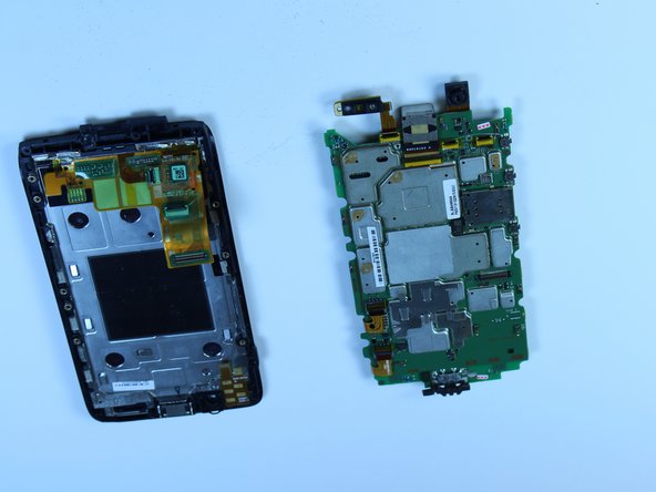

    • Pull out the volume keys using the iFixit opening tool.
  2. Motorola Droid Mini Camera Replacement: crwdns2935265:02crwdnd2935265:01crwdnd2935265:02crwdne2935265:0 Motorola Droid Mini Camera Replacement: crwdns2935265:02crwdnd2935265:02crwdnd2935265:02crwdne2935265:0
    • Pry off the back case gently using the iFixit opening tool.
    • Make sure to go around the entire perimeter of the case.
  3. Motorola Droid Mini Camera Replacement, Camera: crwdns2935265:03crwdnd2935265:01crwdnd2935265:01crwdne2935265:0
    • Use a T5 Torx screwdriver to unscrew the nine silver screws from the housing frame.
  4. Motorola Droid Mini Camera Replacement: crwdns2935265:04crwdnd2935265:01crwdnd2935265:01crwdne2935265:0
    • Carefully separate the housing frame from the motherboard.
  5. Motorola Droid Mini Camera Replacement: crwdns2935265:05crwdnd2935265:01crwdnd2935265:02crwdne2935265:0 Motorola Droid Mini Camera Replacement: crwdns2935265:05crwdnd2935265:02crwdnd2935265:02crwdne2935265:0
    • Carefully use the tweezers to separate the motherboard from the screen.
  6. Motorola Droid Mini Camera Replacement: crwdns2935265:06crwdnd2935265:01crwdnd2935265:02crwdne2935265:0 Motorola Droid Mini Camera Replacement: crwdns2935265:06crwdnd2935265:02crwdnd2935265:02crwdne2935265:0
    • Carefully use the tweezers to remove the flash motherboard.
  7. Motorola Droid Mini Camera Replacement: crwdns2935265:07crwdnd2935265:01crwdnd2935265:02crwdne2935265:0 Motorola Droid Mini Camera Replacement: crwdns2935265:07crwdnd2935265:02crwdnd2935265:02crwdne2935265:0
    • Use tweezers to remove the camera from the motherboard.
