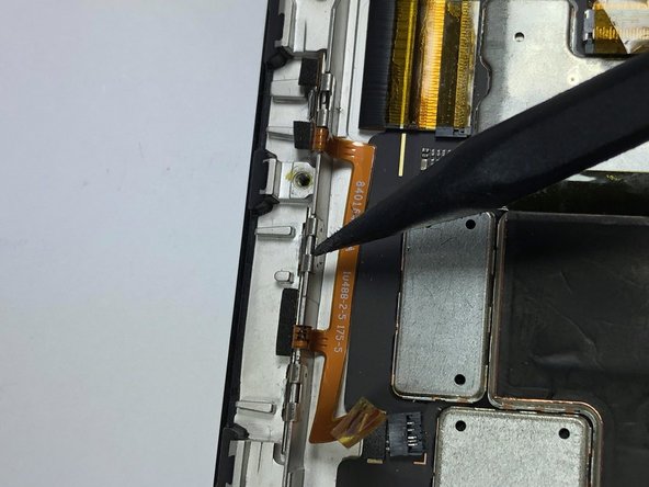

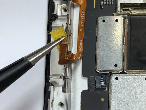

    • Peel back the orange adhesive covering the ZIF connector.
  9. Motorola Droid MAXX 2 Button Assembly Replacement: crwdns2935265:09crwdnd2935265:01crwdnd2935265:02crwdne2935265:0 Motorola Droid MAXX 2 Button Assembly Replacement: crwdns2935265:09crwdnd2935265:02crwdnd2935265:02crwdne2935265:0
    • Lift the black tab on the ZIF connector up.
    • Pull the ribbon cable out of the ZIF connector.

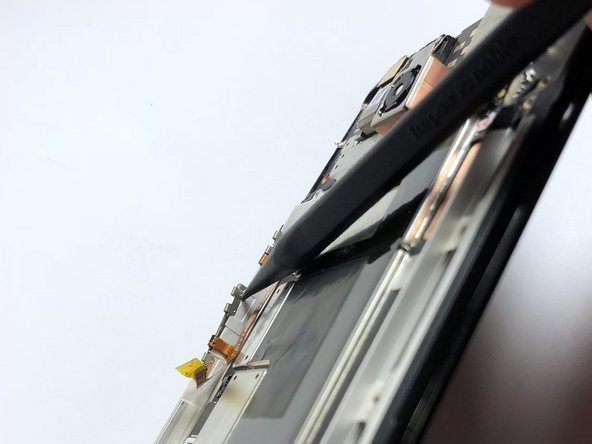

    • Use the plastic spudger to loosen the metal prongs that hold the button assembly onto the phone.
  11. Motorola Droid MAXX 2 Button Assembly Replacement: crwdns2935265:011crwdnd2935265:01crwdnd2935265:01crwdne2935265:0
    • Pull the button assembly up and out of the phone.
