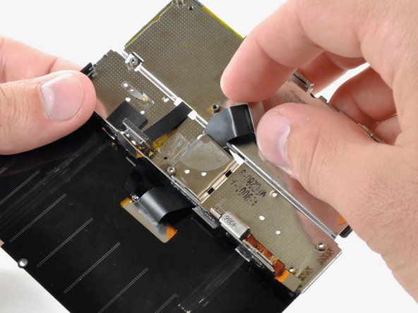

    • Peel the display ribbon up from the keypad's metal backing.
    • The ribbon cannot be completely removed yet, because it is attached to the back of the LCD.
  26. Motorola Droid LCD Replacement: crwdns2935265:026crwdnd2935265:01crwdnd2935265:02crwdne2935265:0 Motorola Droid LCD Replacement: crwdns2935265:026crwdnd2935265:02crwdnd2935265:02crwdne2935265:0
    • Insert a spudger between the back and front case of the display assembly, and peel the two ribbon cables off the two adhesive pads along the back case of the display assembly.
    • The location of the pads on the back case is shown. The top left corner of the case is the corner of the phone shown in the first picture.
