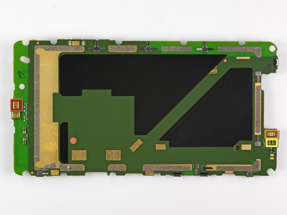

    • What's this? Did we use Content Aware to remove all of the chips from the back of the motherboard? The answer is no; there just isn't much going on with the backside of the board.
    • We find a microphone (red), proximity sensor (orange), ambient light sensor (yellow) on the back.
    • It is possible that Motorola placed all of the chips on one side of the board to keep the thickness of the device to a minimum.
